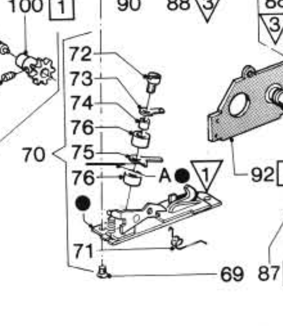

The x-synch mechanism is in the camera body and may be in need of repair or adjustment.
