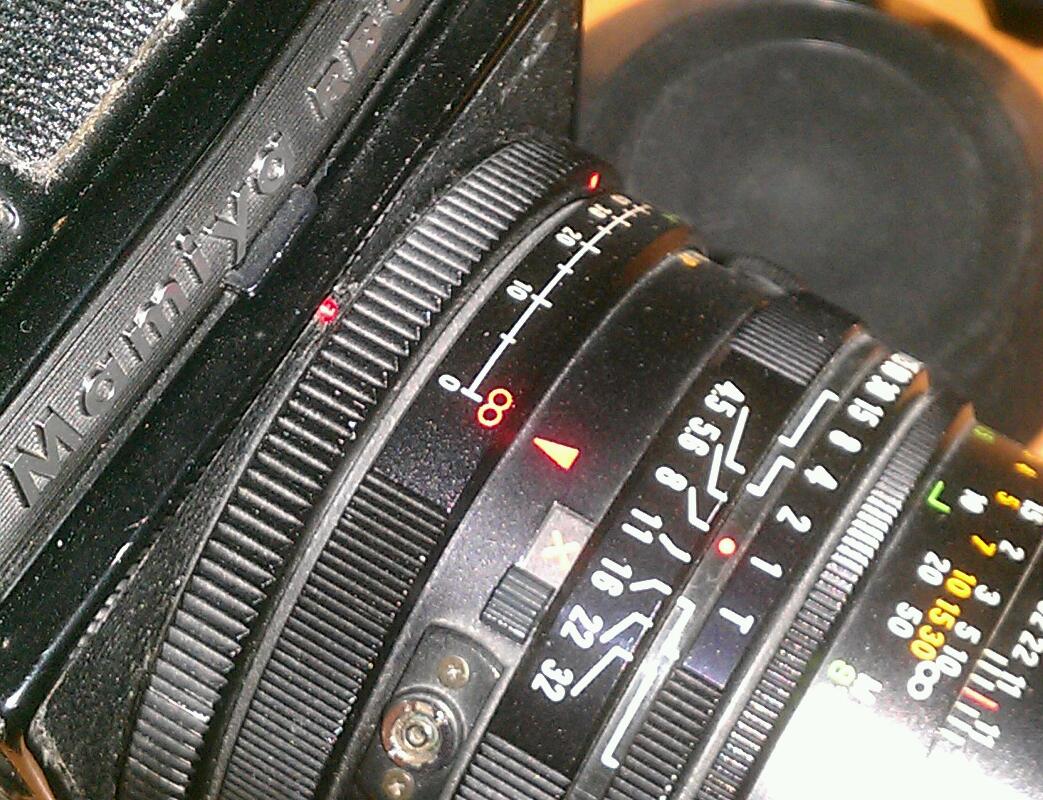

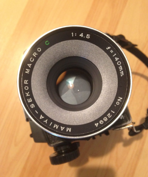

Whoa, now this is very strange indeed. Here are images of my lens, front ring and aperture ring:

Huh, how strange! But it makes sense now that I've seen your "normal" lenses… Sake at lunch it is.
I'm happy that at least the other values seem to be correct! :happy:

Have you verified the step from 5.6 to 3.8?
That to exclude the erroneously engraving, which I find harder to believe than two versions and a mismatched front ring.

Verify how? Mechanically it all works like a charm. I haven't checked if aperture actually is at 5.6 when I set it to 5.6, but it can't be (much) off or I would've noticed—been using this lens a lot these days.
If there are other Mamiya lenses that open up to f/3.8 and have an aperture ring exactly like this then I agree that wrong engraving is very unlikely. So is that this would've slipped factory QC.
"Repair" sounds plausible, and if that was the case I have to say they did an excellent job, because the lens is in great condition and mechanically flawless.

Did a test by measuring exposure directly TTL instead of exposing film.
Assuming f/5.6 is f/5.6 the widest setting is f/4.5, the click inbetween f/5.0 and all the other clicks on the aperture ring as indicated on the ring itself… so I guess it really is just a wrong aperture ring on there, for whichever strange reason (repair maybe being the one most likely, but why would anyone exchange the aperture ring, which I bet is the last part being damaged of all the parts in this lens).

The aperture ring looks just like an aperture ring on my 90mm Sekor C 3.8 lens. Rings switched at repair or factory assembly.
