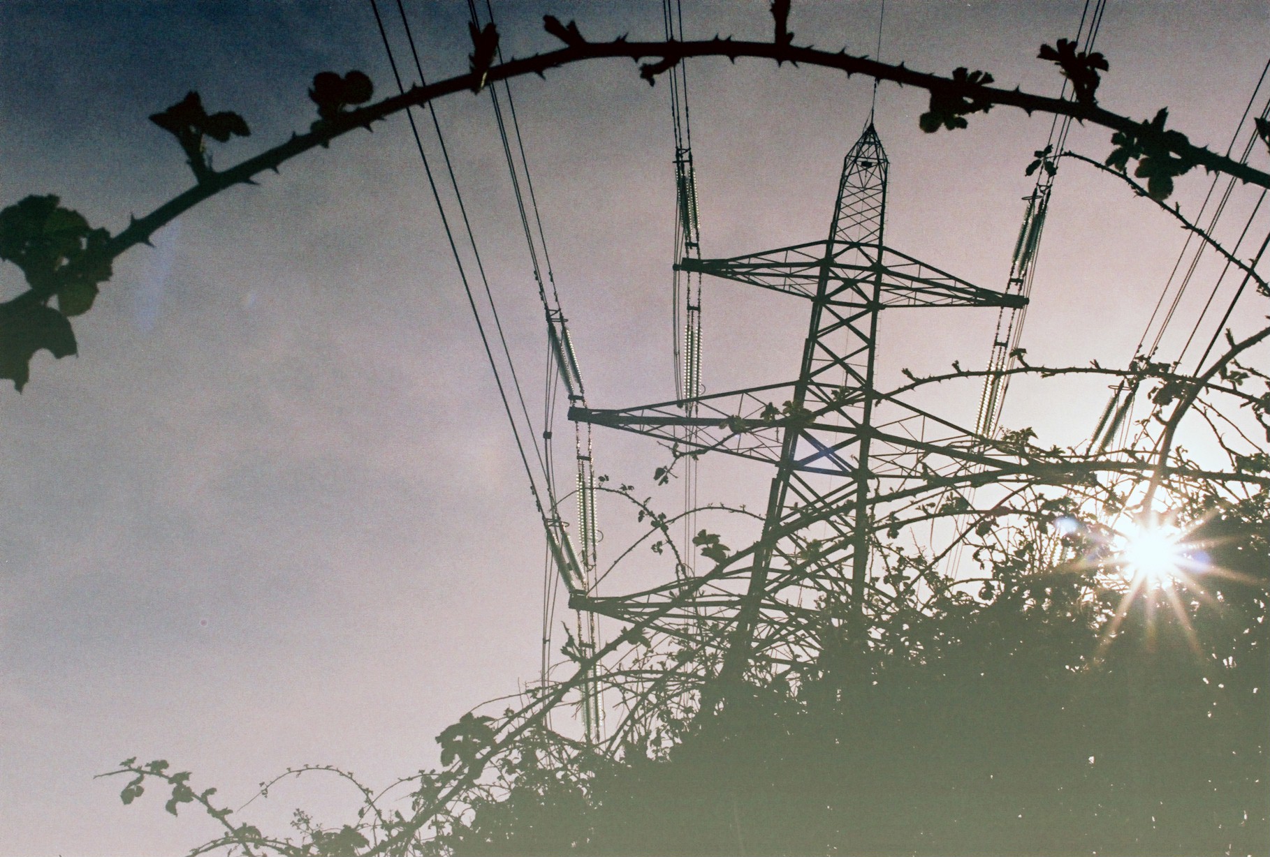

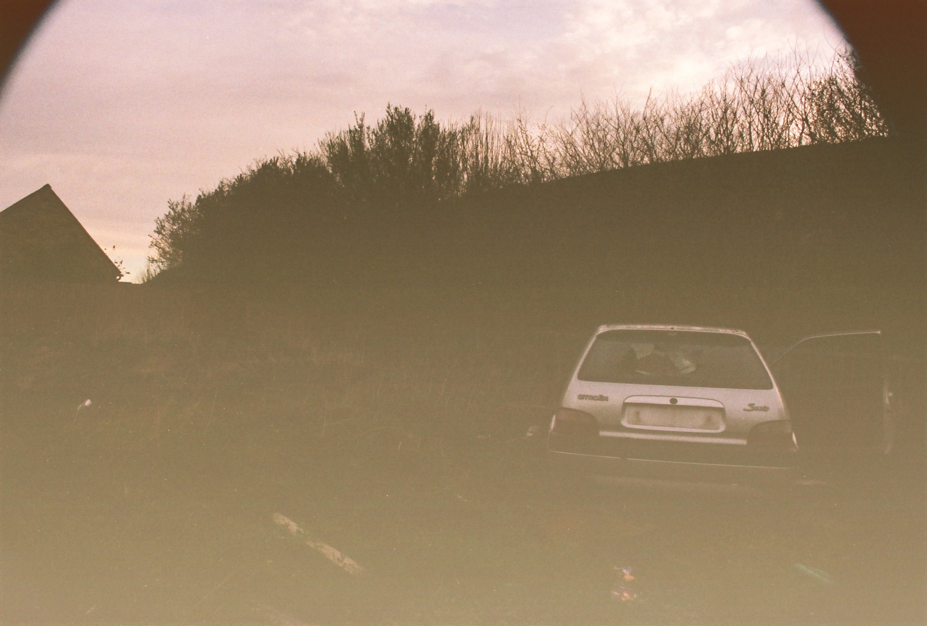

Hi Everyone
I am new to 35mm film photography but have been shooting on digital DSLR for some years and have a good understanding of photography. I was recently given a Minolta 7000 and I bought some cheapish (iso 200)35mm film. I set the camera to P and went out and took some snaps, keeping an eye on Shutter, Aperture and ISO. However they have come out looking like this... Is it something I am doing wrong or is there something wrong with the camera? They all have like a haze to them? Out of the 24 photos I had developed there is probably 1 usable image.

did you develop yourself? looks like processing problem
No I sent to a photographic store in London, they sent me back the negatives and they seem very faded like those images...
I think the camera or the lens might be the culprit;flare from sunlight;missing lens hood or light leak in camera.is it possible light got into the film canister?
Welcome to APUG.

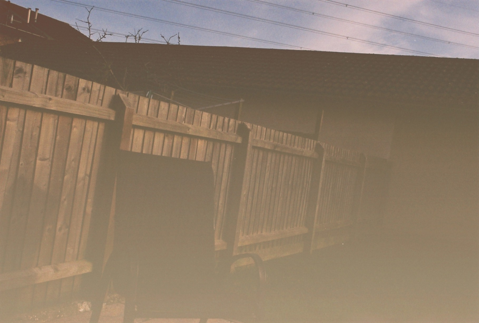

The 4th photo is vignetted. It looks like you used a lens hood that wasn't designed for the lens or focal length you used.
In general, all of the photos look under-exposed to me. The "haze" is the result you get when the lab tries to extract as much detail as possible from negatives that have very little to start with.
The film, of course, has a single ISO - 200. What sort of exposure settings were you using outside in sunlit situations? You should have been using something close to 1/200 @ f/11 - f/16.

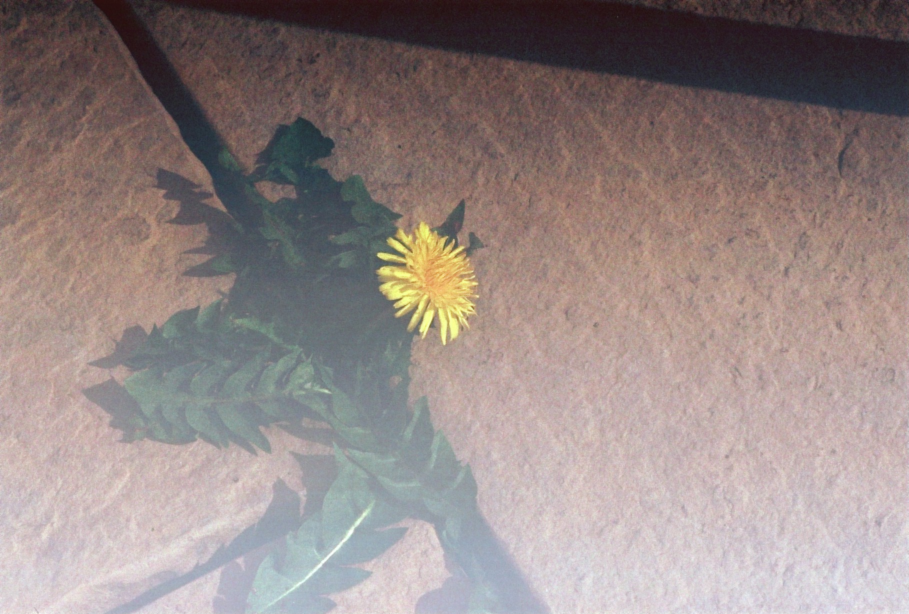

The dandelion looks like a little bit of a light leak. Everything is severely underexposed.
Looks fine if you're into lomo, though.
fogging or flare, probably in camera but could be in processing.
Are results always like this or is it just one roll of film from that lab. If the latter then I would suspect its the lab who have fogged your film somehow.
It would be easier if we could seethe negatives, if there's fogging in the margins it's possibly light seals, On the other hand it could be poorly stored film,

Agree with the underexposure resulting in grain when the lab tried to produce a decent amount of detail. in pic 2 the bright bit of bright sun probably made it worse and that purple blob on the left is flare. The film could have been really old or poorly handled before you purchased it. Your camera might be misreading the DX coding on the cartridge, or the metering may be off. After all, that circuitry is 30 years old.
