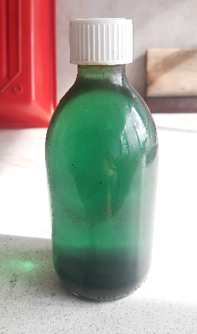

This is a bottle of ID62 developer I keep at hand for various purposes. It has seen a decent amount of Fomapan sheet film. I replenish it occasionally so I can keep using it. As you can see, it's quite green as a result of the antihalation dyes (which are not really a distinct layer as such on the film) dissolved in it. It's perfectly harmless.
If you find you have some remaining green dye in the film after processing, you can take a weak bath of sodium carbonate and rinse the film in that for 2 minutes. Then run it through stop bath and wash it. It should come out clean.
