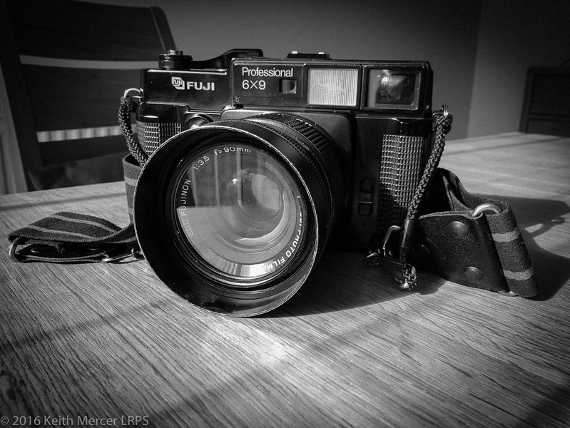

Bought my GW690II from Aperture (London) at the beginning of the year. Cosmetically it shows its age but the performance and results are excellent. Those 6x9 negs! Album on Flickr.
