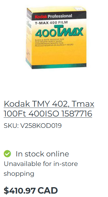

I almost never use the bulk loader to actually load film. I usually pull film out, cut it off, and spool it by hand. There's no waste that way, other than the fact I tend to shoot short rolls. Of course, you need a dark room (if not a darkroom) for that.
Considering how expensive a roll of bulk film can be now
You mean like this?
You mean like this?
😄😄This is a gallows humour laugh and not a joyous one. If they are sold out then could this be because the demand is so great at such a cheap price?
