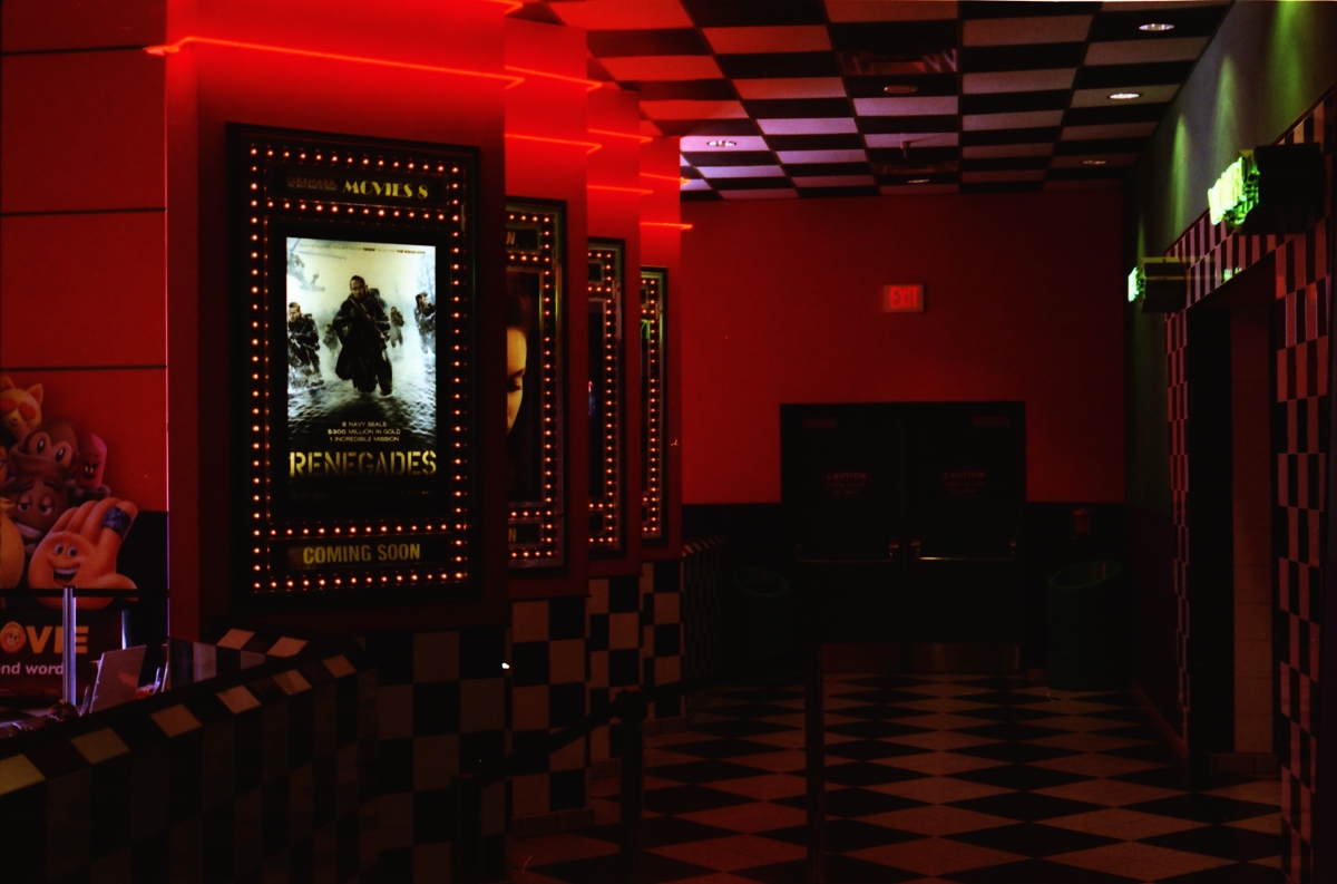

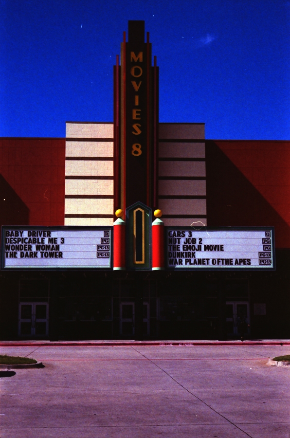

I've recently attempted to push some color film (Fuji Superia 200 to 800) and when I go off to develop it, I get some very dark pictures with oddly saturated colors. I followed the procedure on the unicolor c-41 manual and got these results. Does anyone know what I'm doing wrong and or any possible solutions? Maybe a few tricks? I have had these chemicals for a month but have gotten decent results when I processed non pushed film. Thanks!
You're going to find people here telling you that there is no such thing as a push and etc...
For all practical reasons lets just stick with a push as us idiots think of it.
I don't generally push color film, I find it not to look very good and I always get weird shifts and terrible grain. At least in 135. 120 is a different story. Now, if I do push C-41 I would start with 400 speed or higher. 100 and 200 just don't push so well in my experience. Even with B&W films.
If you are looking for a film that pushing well try some Portra 400 or some of that Cinestill stuff.
Good luck.
I can't remember how many gazillion times this has been said but color film is not designed for pushing. Unlike B&W color must be developed within certain strict parameters. If you alter such things as temperature, the developer time, developer composition, etc you will experience color shifts and cross over.

All a "push" process really does is increase the contrast. That can help under-exposed near shadows and mid-tones look somewhat more pleasing, but the shadows themselves will still be dark, you will have more problems with how the over-developed highlights tend to blow out, and with colour film you will also have problems with colour shifts.
I'm guessing that what you are showing us is semi-automated scans. When you scan over-developed colour film, the scanning software tries to rescue the results. Thus the unnatural increase in saturation. If you dial down the contrast and saturation, the results would instead most probably look grainy and somewhat washed out.
For certain subjects and certain lighting conditions (even, low contrast lighting), under-exposure and an increase in development can be effective. I actually like the effect on the second shot inside the movie theatre. I can understand though why it might not be what you are looking for.

All the advice concerning the poor results of pushing color negs above makes sense. If you must push, there was a trick from back in the days when motion picture film topped out at ASA 100: flashing. The film is slightly exposed to light either before or after the primary exposure and it raises the bottom of the shadows and the midtones. Then push process if needed. Not pretty, but it works. But by far the best thing to do would be to start with a much faster film.
Apr 2, 2017
639
Agree with all of the above. Additionally, the subject on the left has high contrast lighting. This adds to (worsens or improves depending on your creative goals) the effects of color shift and lack of shadow definition noted above. Pushing color film with a low contrast subject may produce results that, depending on your creative goals, appear less as garbage. Give it a try.
For a d******l comparison with a high contrast subject, set the ISO to 200 and use manual control of shutter speed and aperture to arrive at a 2 stop underexposure. If the results are not garbage to you, the solution has been found.

Stating the obvious but both pics seem to have a strong red/magenta cast in the positive so I am assuming that this is reflected in the cast in the negs. Given the magnitude of the cast I'd be surprised if normal RA4 processing under an enlarger can correct this. It may be correctable or at least improved with the kind of scanning a mini--lab can do before printing but I know nothing of these matters
From what I have seen and as at least one other has said, starting with a 400 film and attempting a one stop push may fare better. Alternatively consider getting some 800 colour neg

The two images are... interesting. Maybe you should consider using that process to create a moody (dreamy?) series?
Now, if you just want the extra speed and want to minimize distortions, you might consider:
- shooting a gray card; same film, same lighting; and use that to reset the neutral point
- shooting a color target (e.g; Wolf Faust, or other) and profile your process film+dev+s*n*g

Nice effect. As bernard says you can do something there and use the colour shifts to create a vibe

do a test ... a variety of different lighted subjects and bracket your exposures and push process your film
and do the same test and over / under developer in your drum by 30% or whatever the manual suggests for color film / effstop
its like finding your iso sweet spot ... but with less light
i don't really shoot much color but when i did, and i needed extra stops, i just used a higher iso film since i wasn't processing it myself
so i sent it to the lab and got expected results ...
its too bad jd callow isn't here, he is a wizard when it comes to color film .. pushing and cross processing
his words are still here on photrio, you might do a search for all the posts he made about the subject

If the color cast is due to crossover then no amount of filtration will correct the problem. When you increase development it is the top layer that receives the additional development. If you try to correct the cast from the top layer then the other two are also affected.

Pushing black & white film is not really pushing the film, just changing the contrast. Pushing color film will result in garbage, do not bother doing it.
