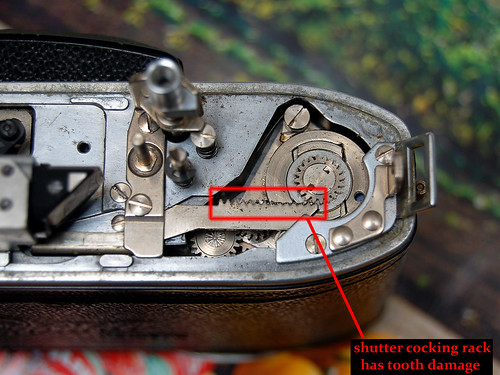

I just purchased a IIc on ebay and the shutter is completely stuck and/or the wind mechanism that resets the shutter has a problem.
I am not technical enough to tear it apart and fix it myself, so I'm curious of where to send it to be cleaned and repaired.

I have a Retina 3c that I thought was stuck...but it was just the film counter was at 36 which locks up shutter/film advance automatically...once I found online how to reset the counter...it worked fine again
Nah, my issue is that the wind lever is skipping off of the gears that make it recock the shutter. And the shutter itself may be frozen. There's not visible oil on the blades on either side, but it's possible it's frozen since everything was all gummed up when I rotated the shutter speed dial. If it's going to cost me more than the going price of a CLAed IIc, I'll probably try to figure out how to take it apart myself, but from what I read, the cocking rack is broken in mine and needs replaced.
Cocking rack
Microtools has or had the racks.. Dave
I forgot to check up on the thread. I removed the top of the camera to get a looksee at the cocking rack and mine is indeed devoid of its teeth:
I'll be in contact with micro-tools shortly to purchase the replacement part.
I manually cocked the shutter and it fires, so that's promising.
