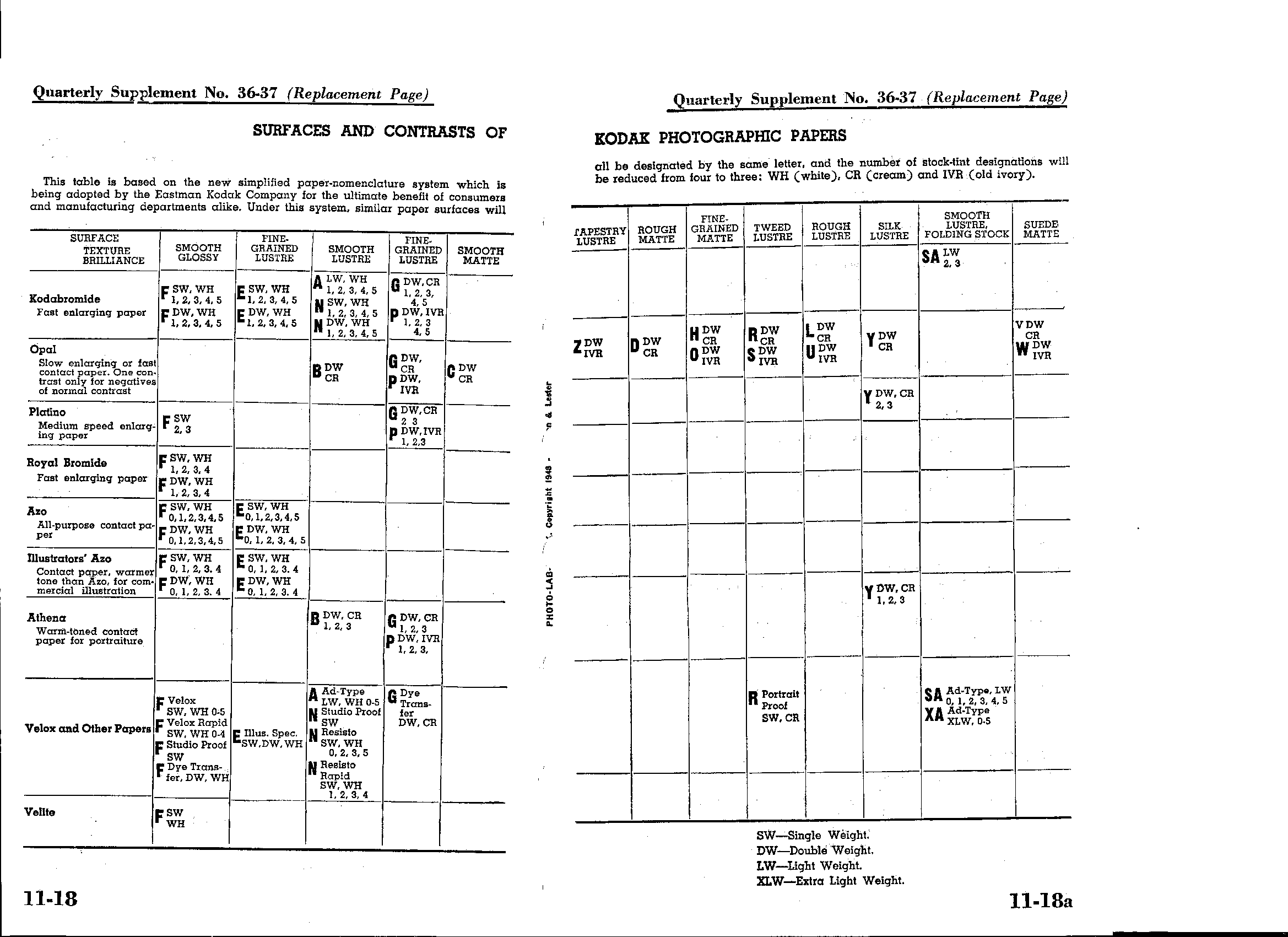

It's certainly not like the old days (see attachment). You have to go digital to find a really wide selection of surfaces and colors these days. But looking in the Freestyle catalog shows that there is some variety available. Foma seems to have the widest choice, offering glossy, "velvet," and matte. Foma also gives you a choice of white or cream-white base color for some papers. But be aware that the "Luster" surface ("luster," "pearl," "velvet," etc.) varies a quite a bit from brand to brand. Also, FB papers are not the same texture as RC papers. You can still have fun, just not quite as much. Kodak_surfaces.png
