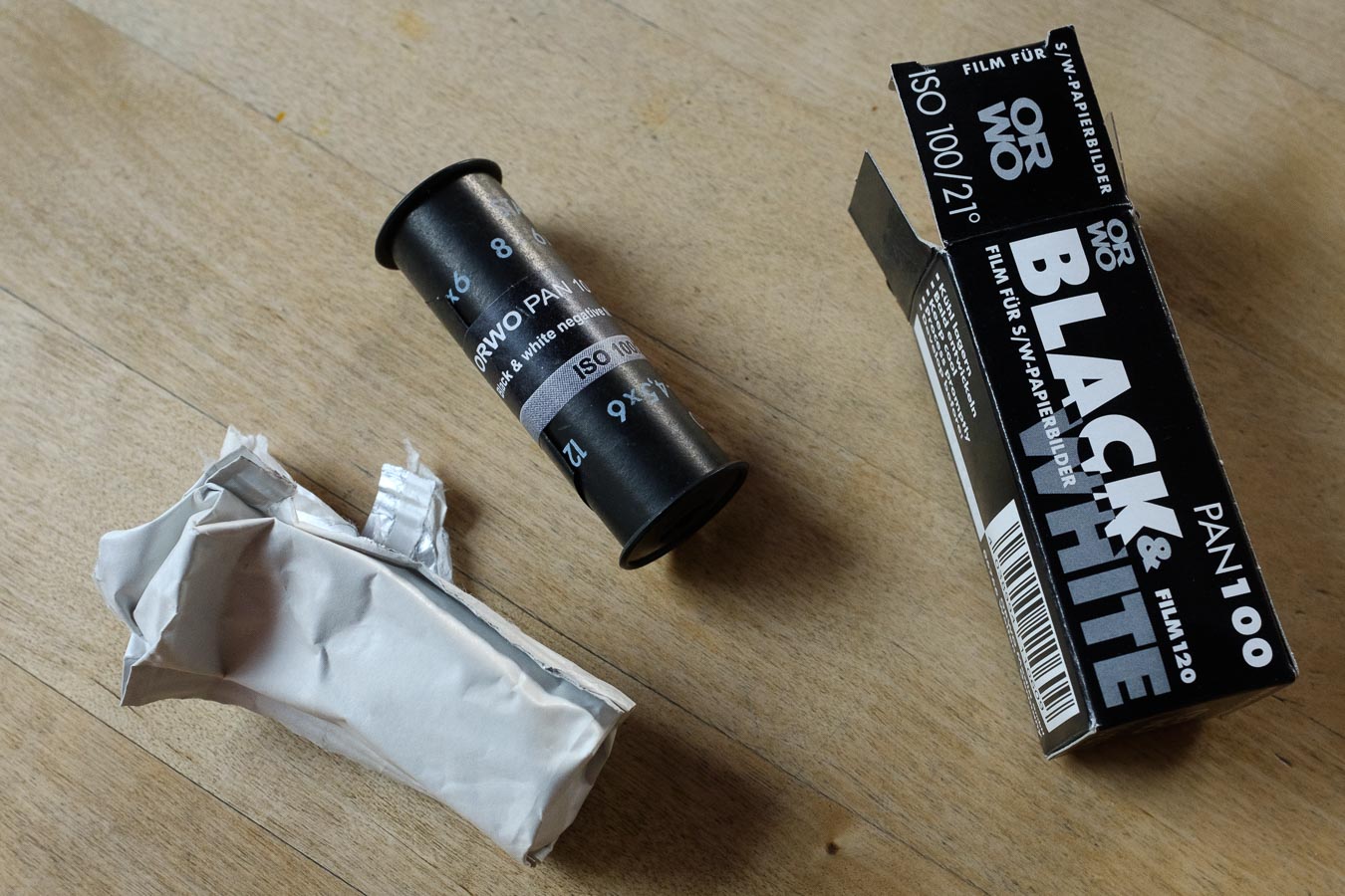

Hey, I got 20 rolls of a film I never saw or used before:
Does anyone know it? It might be a repackaged film, so would be interested in what it really is and even better: how to develop it in ID-11.
Thanks and cheers
Ruediger

Never saw this either. I only know of the Ilford made films from the early 90's for back then still existing ORWO, but those had the yellow-on-black design. (That came at least for type 135 in two package design versions, with different amount of yellow striping.)

The expiration date is 2005.

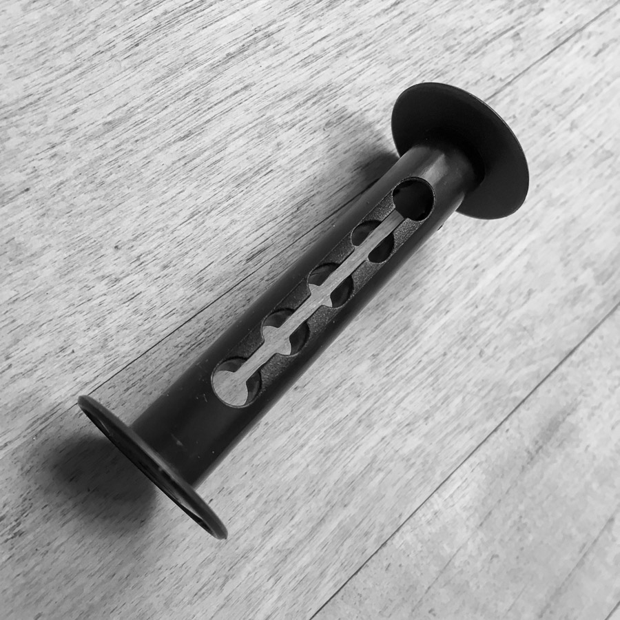

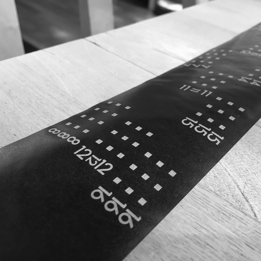

Thanks for all the info. I have used one roll with an exposure series. And also exposed a roll by rating it at 50ASA. I am going to develop it for 10 minutes at 20°C in ID11 1+1, that should not be too far off.
The backing paper is black with text printed in white and the reel looks like in the images below:
Cheers
Ruediger

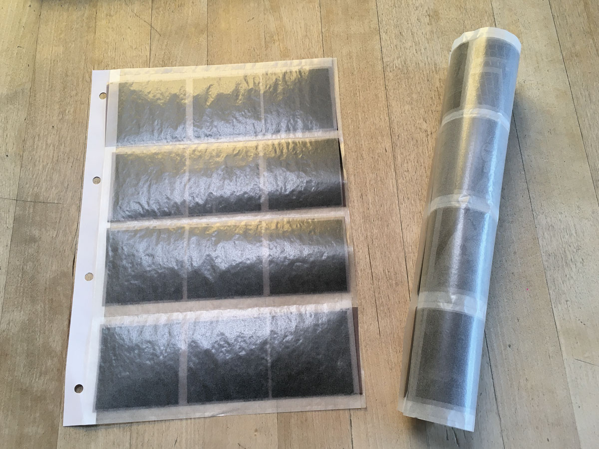

Just for fun to show what I mean with "tendency to curl", on the left Ilford HP5+, on the right Orwopan 100.
Time will tell how long it takes and how many books it needs for the Orwo to get it ... kind of flat. At the moment it is no fun to work with.

yikes—that's some crazy curl! :surprised: hopefully, once flattened, the results will justify the extra hassle.

In the last 10 or so years I used 15-20 rolls of this film. Unfortunately all of mine come with out outer box, just in white wrapper as in your pictures with the same backing paper and roll. It's very decent film. I have a few rolls left. From everything I saw it's identical film as ORWO NP-20 from the 80's and I used hundreds of rolls of it in that time. It's not Ilford or Forte or anything else repackaged. Most likely they had master roll siting in cold storage from who know when and they finally cut it up. I used it at 64ei and processed it in previous version of HC110 - H dilution.
And yes, left overs from this master roll were used as shock absorbers for sleeping railway cars. :cool: It has crazy strong curl in it.
