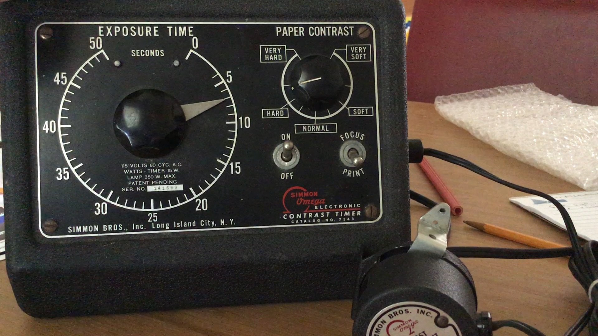

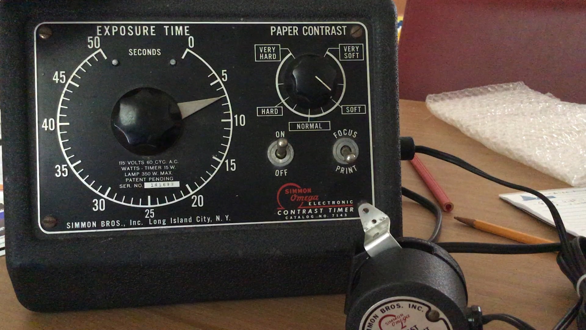

Kuhn's text aside --
Dupont had Varigam and Varilour -- special printers (split filter) were made for the mass production labs. Reminder: paper came with instructions on making the filters to use.
The smaller lab had something like this analog computer:
[frames only; can't upload MOV]
View attachment 286199 View attachment 286200
Thanks for the pics. Now that is the kind of computer that appeals to me. It looks intuitive and I bet it works that way as well
