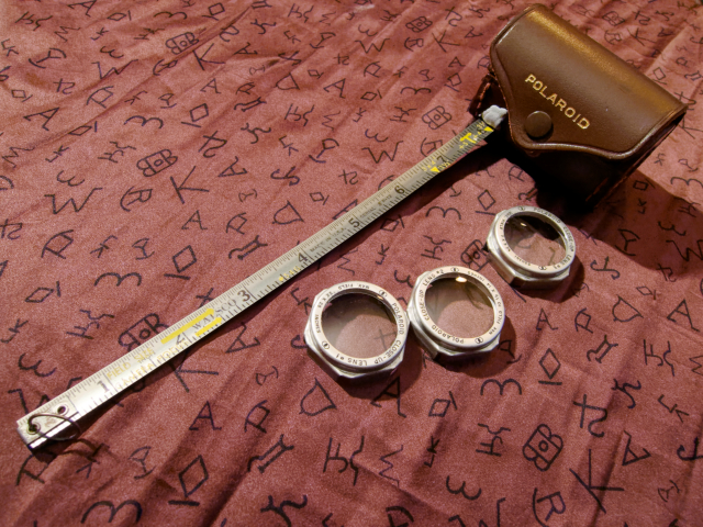

I picked up a set of Polaroid-branded close-up filters some months back at the local antique mall whose case contains a built-in tape measure demarcated with field size, camera focus, and and close-up filter settings. While not particularly useful for how I use the filters, its still a very useful piece of kit that adds versatility to an otherwise crippled camera.
