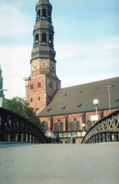

I finally found the right place to put the pinhole in my Agfa Box without resulting with vignette.
It would be perfect if it wans't the white spot that came out in the middle of every frame.
I guess it is the reflected light from the pinhole Metallic part, bouncing lighting on the glass in front of it that bounce the light back into the pinhole.
The only way to correct 100% seems to taking the glass of the camera out.
But just in case I am missing something I would like to know about others here opinion about what is causing it and its and correction.

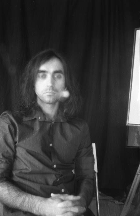

Here an example from a self:
Hamburg - Fomapan 400 at 1600 in 6x17 frame - Marcio Faustino - 2015  - 179.jpg

I'd say you're correct.
If you still want glass in front, tilt it enough that the spot no longer lands on the film. Or use a dome (with no optical power). Otherwise remove it.
Sirius Glass
Jan 18, 2007
50,415
Southern California
Or remove the glass. Optically it is not needed and it is providing a reflective surface.

I have to admit I have a problem visualizing what could produce that and yet have the rest of the frame as well covered as it appears. Are you using the camera's shutter to control the exposure? Any possibility the shutter is not closing properly? With some spacing between the shutter and the pinhole plate, the result might be like shooting through a cylindrical hole and projecting the shutter leak via the pinhole. (I am assuming it is a vintage leaf shutter that opens and closes near the center optical axis.)
Maybe try some shots controlling the exposure with a lens cap and the shutter on Time or Bulb as a test?

You are likely to be right.
I will try it.
Thanks.
