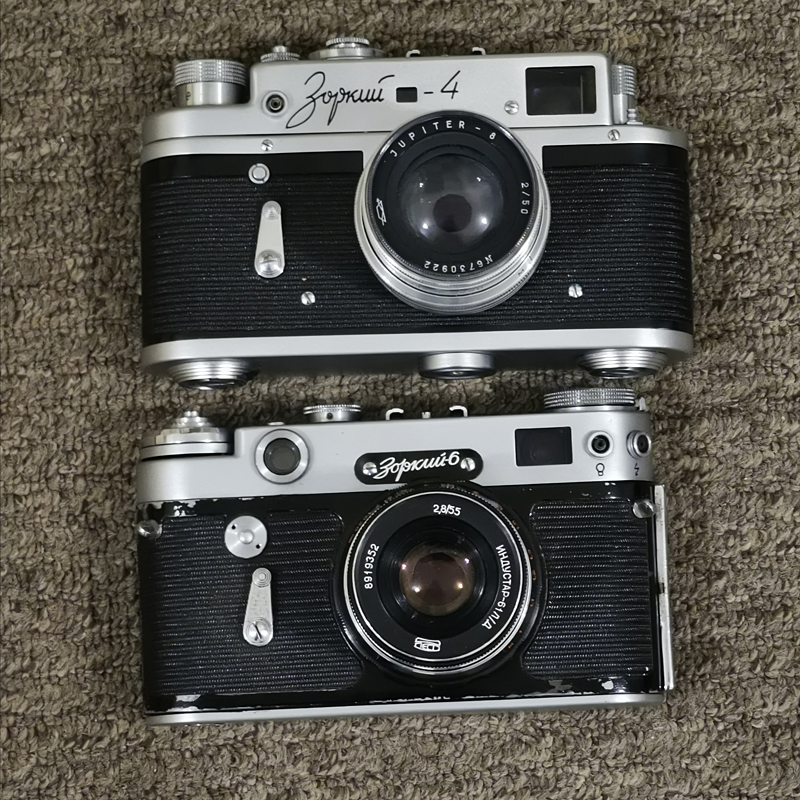

I have a small collection of FEDs and Zorkis and agree with Cameraquest , the Zorki 4K and Zorki 6 are my favorites from an ergonomic aspect.
Here are my 1970 Zorki 4 with no strap lugs or lever wind and my 1961 Zorki 6 which has strap lugs and looks the part but has a smaller viewfinder.
The later models with built in light meters were not so good looking IMO.
