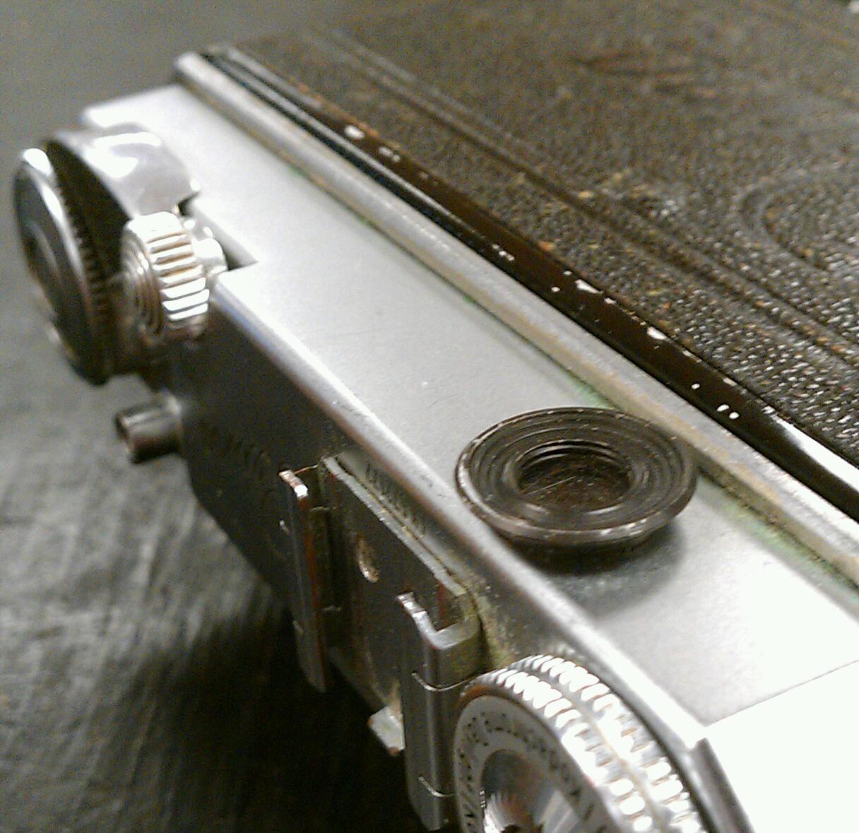

On the IIa, I don't think so. Thankfully, it doesn't scratch my glasses.
Just made this photo of mine:
