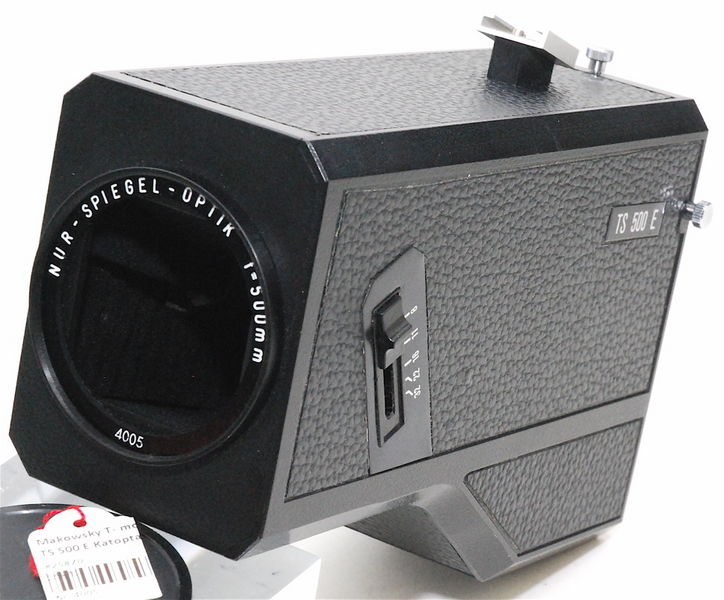

That was probably one of the earliest Reflex Nikkors:
http://www.mir.com.my/rb/photography/companies/nikon/nikkoresources/telephotos/50cmf5/index.htm
At f8 and 500mm DOF is as thin as a sheet of paper... but at f5.6 And there is no such thing as stopping down to f16...
I remember there was a few single mirror lenses that could be stopped down and had a normal bokeh, but they had a reputation to be as useless at f8 as on f16, due to a siginficant lack of sharpness and contrast.
http://www.fotowiesenberg.flagencal.de/obj_telespect500mm/obj_telespect500mm_en.html
I saw that the patent is available online. If one of you is a better engineer go ahead and make that work
