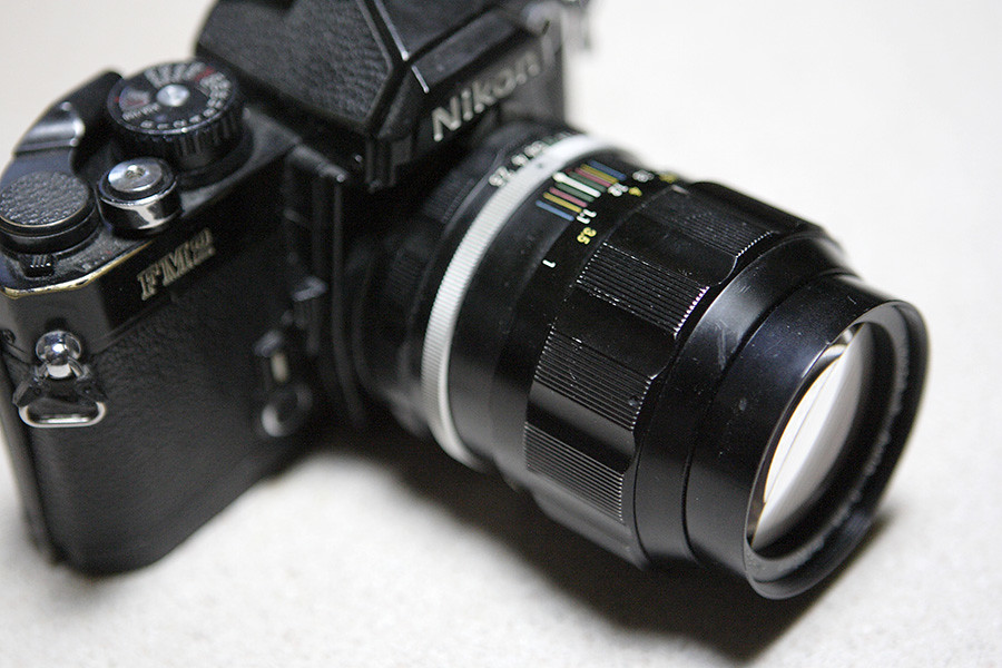

I have the Nikkor-P Auto black nose, knurled wide focus ring, chrome aperture indicator ring.
Build quality is excellent as you'd expect but I think I need to have the lube repacked to tighten up the focus action a bit.
Mine appears to be factory AI'd and is from the optical formula transition period.
I haven't been able to discern if it is earlier Sonnar or the later Gauss design but it matters not (to me)
Does anyone know how to identify the lens design? Serial number info is conflicting on the net but I heard somewhere you could tell by position of the rear element? ? ?
Always been a great performer.

Bruce, the 105/2.5 on your FM2n has a mill job... Still has the scalloped aperture ring. The factory AI conversion kits used a ring that looked identical to the factory AI lens aperture rings, except for one thing. f/32, instead of f/22 as the min. aperture on the black barrel lenses. I've owned three Gauss design 105/2.5's. An AIS version with the hood, a Nikkor-P version, and a factory AI'd K lens. It is possible to de-AI a factory AI lens, btw. Just put a ring from a non-AI version on it. Not sure if that would enable f/32 on the formerly AI lens, though.

Later Gauss design has a rear element that fills the bayonet. Early Sonnar rear element is 2/3 the size. In close up range, it is not as sharp at 2.8 and 4.0.
Have two Gausses and one Sonnar that is factory fresh and mint. For all normal pictures, the images are identical.

Okay, I had heard you could tell the lens design from the rear element. Thanks Ron.
And thank you John for the info regarding the ai conversion.
It appears I have the gauss design with a 3rd party conversion.
This lens got sidelined for awhile but I am shooting it much more frequently now.
