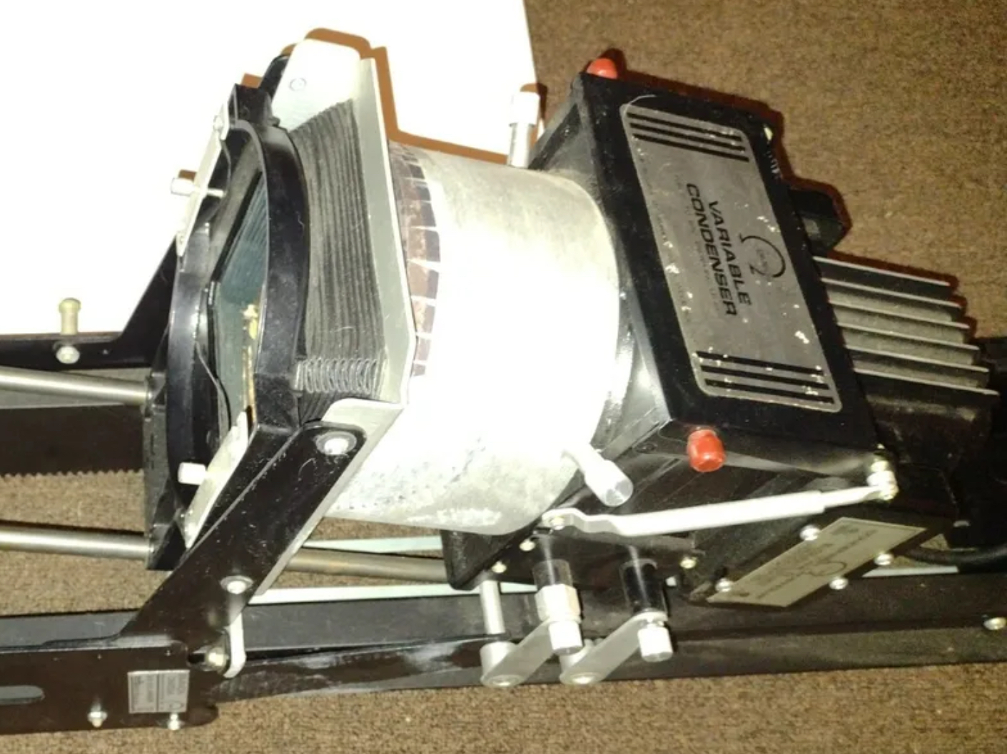

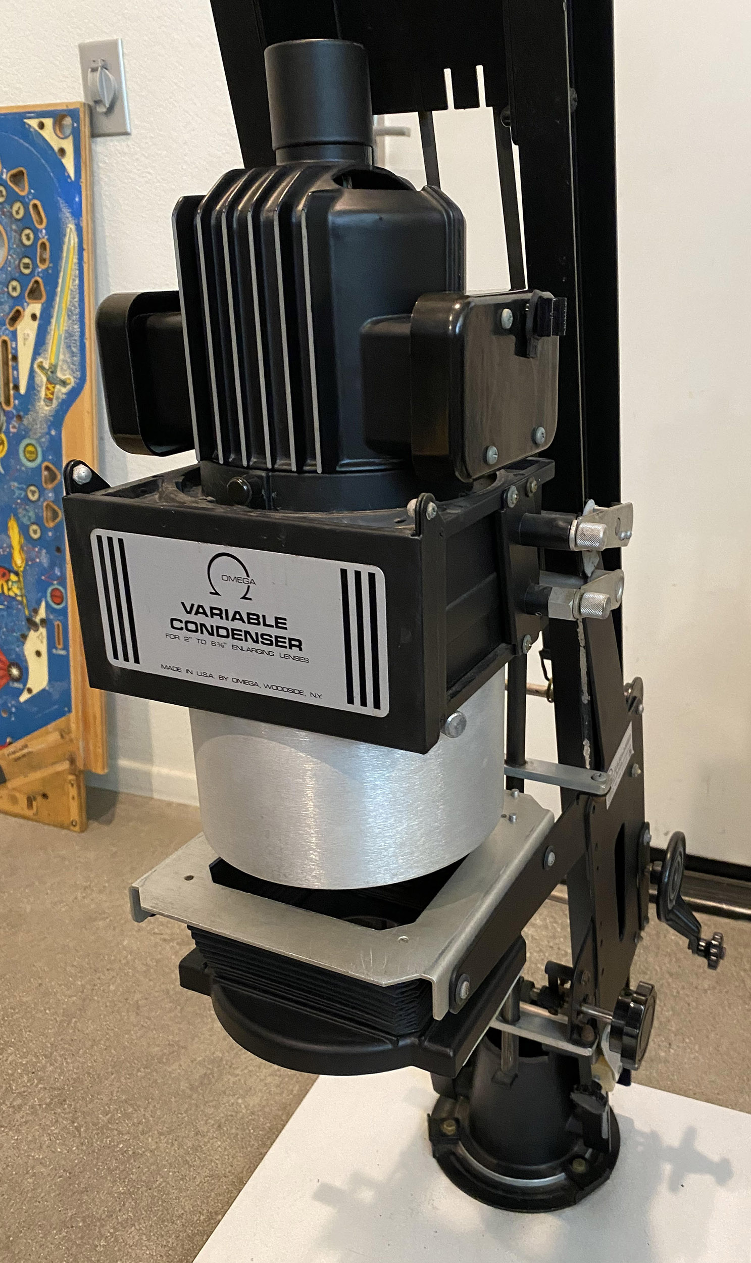

Can someone identify which Omega version this is? I couldn’t find a photo online, with the associated model info, that matched the look of this one exactly.

Looks to be a D2 no focusing rails so not a D3 the model is found on a plate attached to the column, you can see the plate but I cant make out the model.

Please post a photograph of the front plate and the small print on the white part.

Have no other pics to post, this one's on eBay. If it's a D2, it requires the lens cones to match the lens in order to focus correct? I'm looking into enlargers as I'm going to build a darkroom sometime in the future. Figure I might as well collect some stuff while prices are low but I'm really just familiar with the Beselers since that's all we had in the darkrooms when I was using them in college.

The D2 to early D5 used a cone for the 90 to 105, then a second cone for 135 to 162. Beselers and later models Omegas used a double bellows that replaced the cones. In addtion without opening the condenser housing you don't know if the second condensers is there. The Omega variable condenser allowed the upper condenser to be moved to optimize the light for 35mm to 4X5.

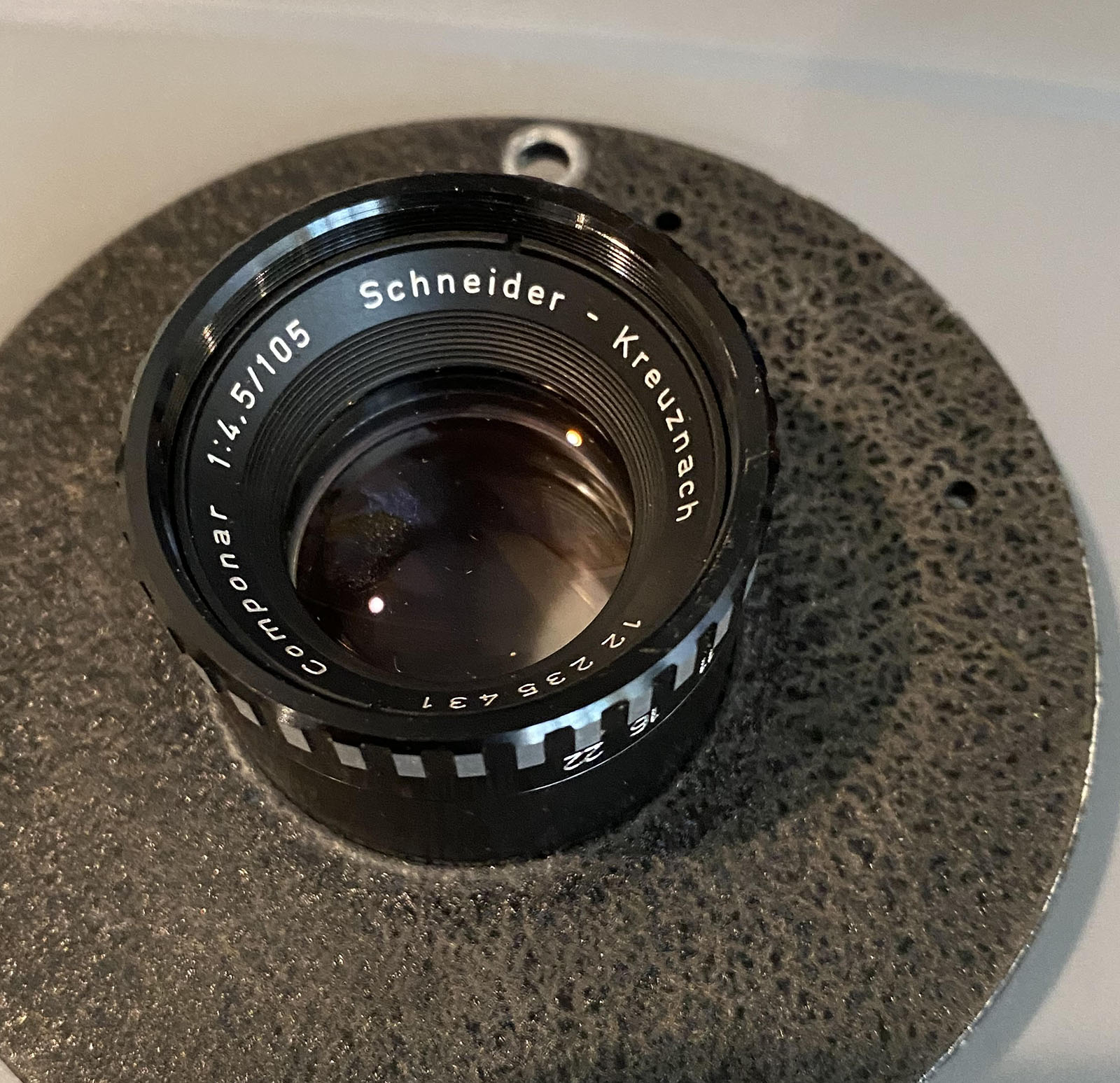

So I picked up an Omega. Not the one pictured but another from a CL seller and it's exactly as ic-racer described... a D2 with the variable condenser lamp house. This was a smokin' deal I think, $50 for the enlarger and loads of stuff, negative carriers for 35, 6x45 6x6 and 4x5. Got a premier 4 in one easel, an analog GraLab timer that works, a cute little Arkay safelight, a couple other random negative carriers and so forth. Oh, and a set of Ilford below lens contrast filters. It's missing the filter tray and possibly the heat absorbing glass? Not sure if the Omega is supposed to have either by default. There's also no cones and the only lens I found was a 105mm Schneider in really nice shape. All the condensers were present and the lamp is still good too. I already pulled the janky power cord out so I can replace it, did that before I took a photo.
Any tips for servicing it? It goes up and down fine and the focus is ok, but I'd call it a little stiff.
Any tips for servicing it? It goes up and down find and the focus it ok but I'd call it a little stiff.
View attachment 309213 View attachment 309214
Ensemble of great compatible equipment that will serve you will in your darkroom work. Enjoy.
There is no filter tray, the 6x6 filters just go in the variable condenser housing, either on top of the condenser or at the bottom, depending on the condenser position. And the heat absorbing glass is an accessory. It also goes in the variable condenser housing, usually in the top slot.

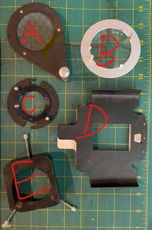

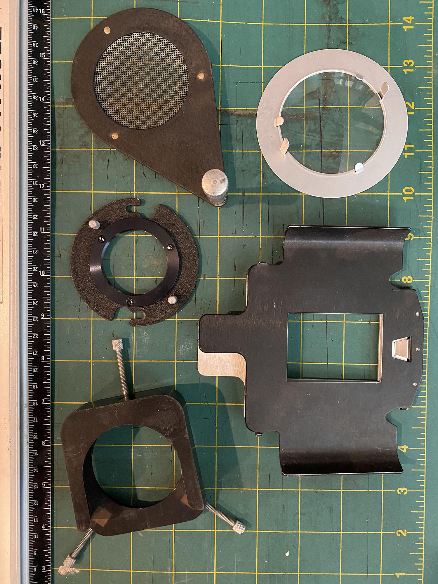

I went though the box of carriers and other stuff I got with the enlarger... does any of this look familiar? The 6x4.5 carrier is clearly for some smaller enlarger of some sort. Not sure if the twist on lens mount is Omega or not and I have no idea what that screen thing, or the silver bit that looks like a low strength magnifier is. The filter holder also seems like it's probably for some other type of enlarger.
MattKing
Apr 24, 2005
53,145
Delta, BC Canada
A. Something like a swing away diffusion filter that is intended to mount on a post attached to a lens cone or board.
B. The holder for a condenser lens.
C. Lens board.
D. Negative carrier for something like an Omega medium format enlarger.
E. Holder for variable contrast filters that you attach to the lens.
A., B, and C. could be specific to a number of different enlargers, although C. could certainly be intended for mounting to a lens turret for your enlarger.
E. looks like it might have been designed for the under the lens Kodak Polycontrast/Polymax variable contrast filters, but the Ilford version should also fit in it.
