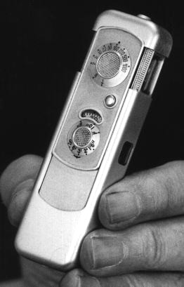

I don't shoot Minox subminis now, but I did 1967-1970 and 1995-2018. I have both a B and IIIs.
I had my first Minox B in the 60s... and quickly found the selenium meter was ONLY useful in bright conditions. Fantastic technology, but that meter wasn't good for interiors and low light situations. I'd end up guestimating.
When I got back into shooting Minox in the 90s, I chose a IIIs because it's even smaller and simpler. Estimating exposure with the Minox is easy because of its fixed f/3.5 aperture: the shutter speed is the only variable. I standardized on 100-speed films and did very well without a light meter. (When in doubt, I'd bracket the shutter speeds: I was loading my own cassettes and film was only costing me a dollar a roll!) For me, the tiny IIIs is just flat-out cooler than the B.
But this is me - I really like the challenge of shooting totally manual cameras. These days, I largely shoot with a Pen F and Nikkormat (with a flaky TTL meter) and rarely carry a hand meter. Just this week, I bought myself a sample of the most manual Olympus Pen viewfinder camera, the Pen S, on eBay and am looking forward to checking it out. For me, smaller/more manual is always more interesting. But that's me.
Donald, since you say that you're already estimating exposure 99% of the time with other cameras, you'd be an ace with the IIIs. OTOH, if you really want one of the later automatic models, go for it. They're all awesome!
And YEAH, the Minox really does NOT belong in "Lo-Fi cameras", it's a masterpiece of sophisticated twentieth century camera design!
"Product shot" I did for a web article I wrote about different Minox models back in 1998 (whose text has been ripped offf repeatedly since!) That's my dad holding my IIIs, shot with our old flourescent studio lighting in 1998. (100/2.8 Zuiko on my OM-G/OM20, Tri-X/D-76, low-res scan of a 5x7 print... from back in those just-small-JPGs-for-modems days.)
