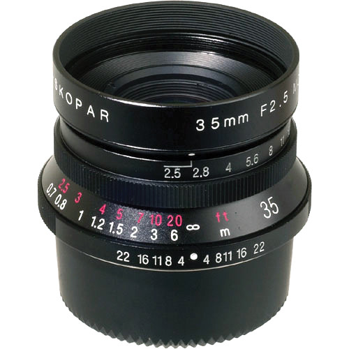

Which lens should I keep? Voigtlander Color Skopar f2.5 35mm CLASSIC or PANCAKE?
Banana
Banana
  • 9
Higher ups
Higher ups
  • 61
200,589
2,810,560
100,308
Sverre gjesdal
Grephenson
May 7, 2022
38
Nashville
Bill Burk
Feb 9, 2010
9,434
I was going to say any time there is a choice, keep the pancake. They always become more valuable.
But the Classic has a bit of a lens hood, less likely to have flare because of the hood. That would be better for your photography.
Huss
Feb 11, 2016
9,058
Hermosa Beach, CA
Keep the pancake. Same optics but no longer made etc.
No need to have two of the same - been there, done that, sold one.
Jan 31, 2020
1,324
Germany
Classic is with the focusing stick? Well, if you can cope with that... I believe the pancake was more or less from the time CV made the lenses that fog, but I don't know for sure, do your research about that
