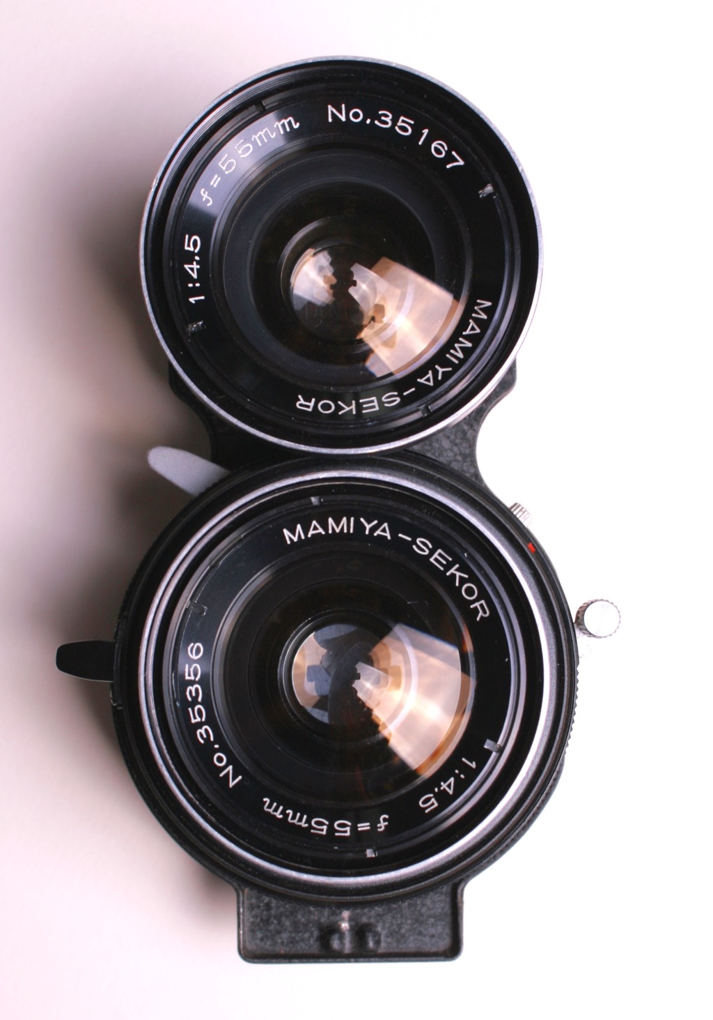

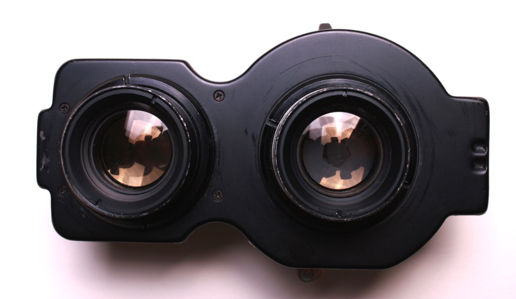

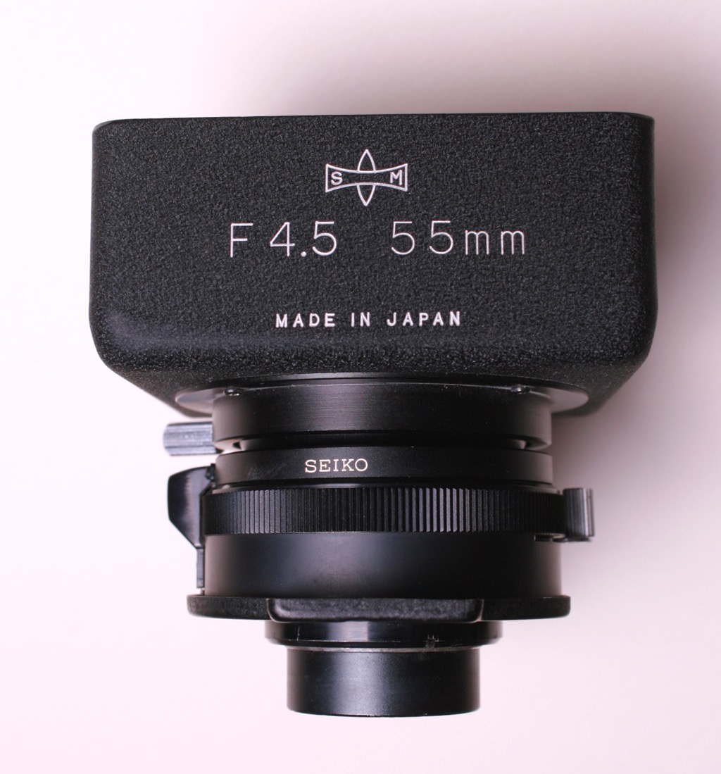

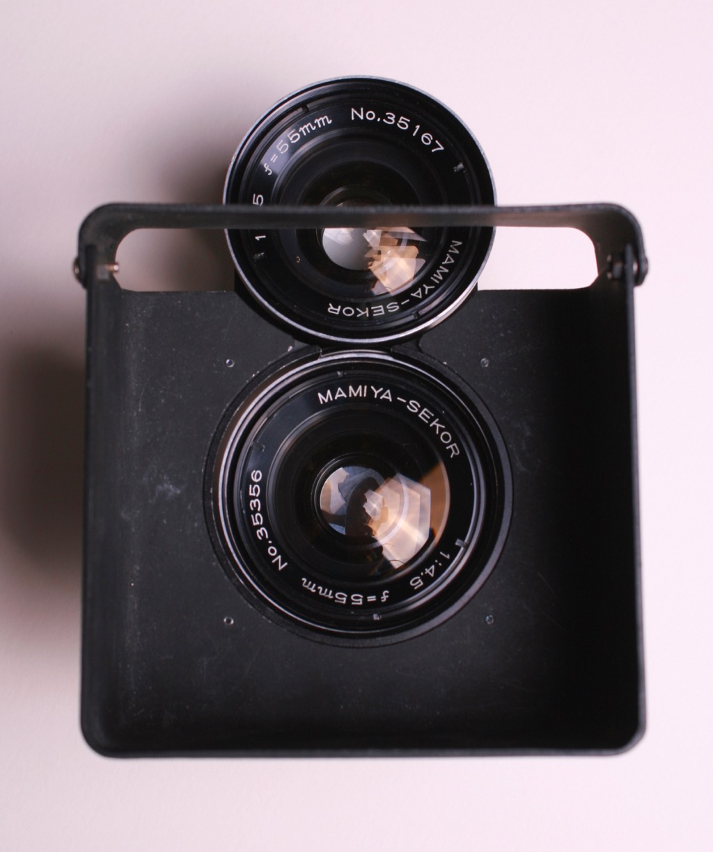

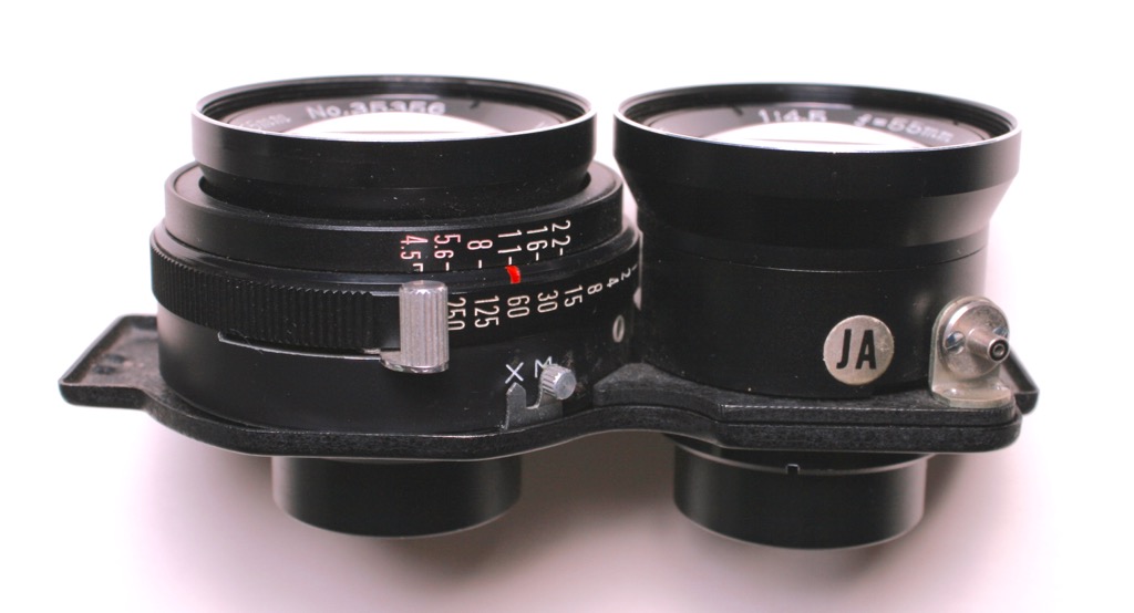

I have a 55mm that I'm willing to sell. It is in excellent shape. Just send me a PM if you're interested.
