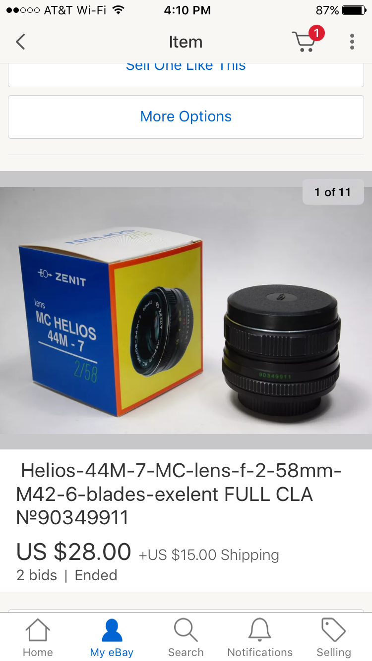

Well, I outbid someone on eBay by one whole dollar and got a hellios mc 44-7 for 28 bucks. I may have been fooled though the serial number begins with 90, not 93. Oops. I can post a photo from the eBay listing later.
