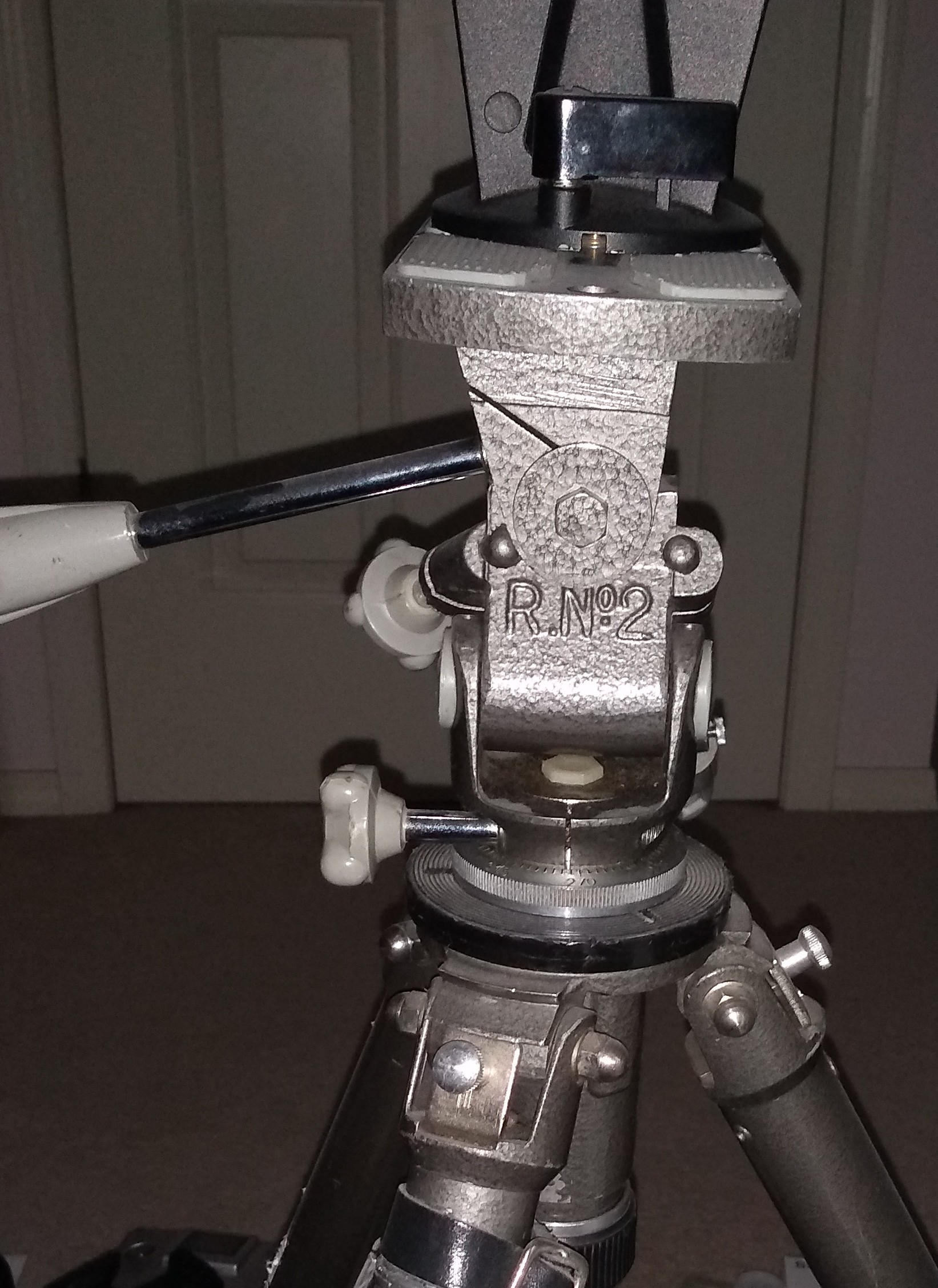

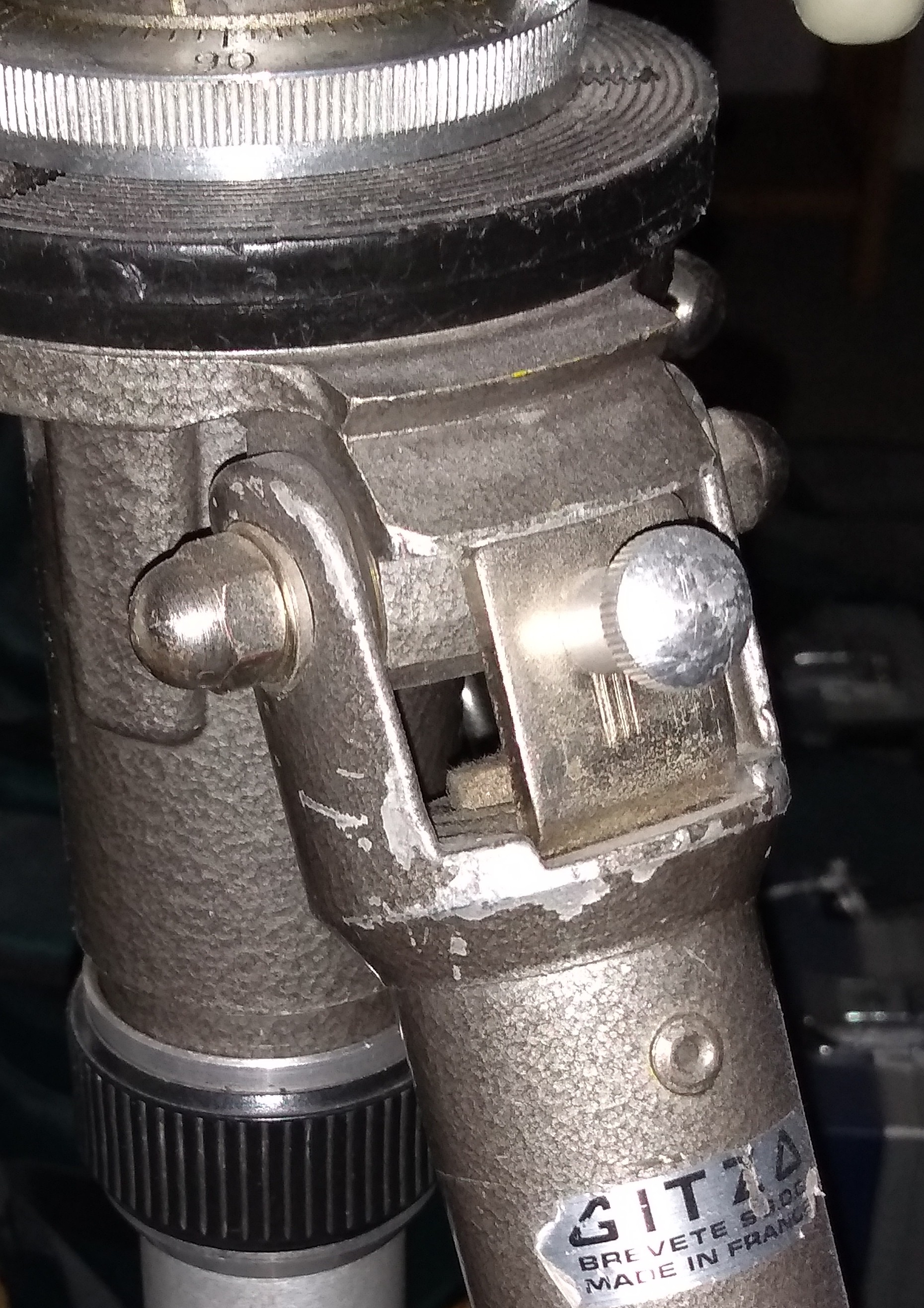

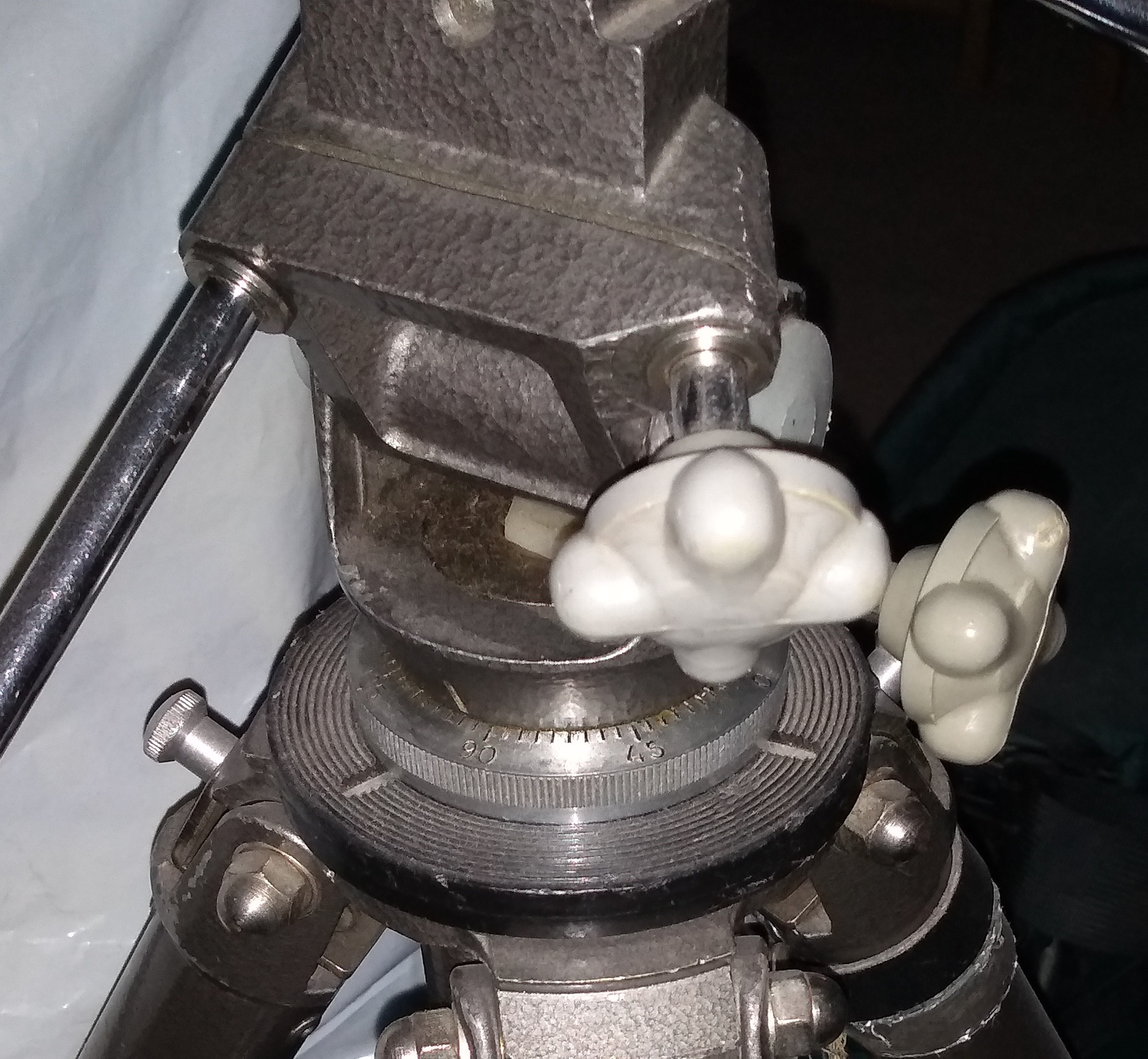

Looking at Wikipedia for Gitzo, I see there are a lot of Studex models. I'm trying to discover which one I have.
A few details:
- no struts from the legs to center column
- lower legs are silver
What is the R No. 2 head? I have a Sinar F 4x5 mounted on it, but it seems this head was intended for something larger - such as a ciné camera or small aircraft.
IMG_20190613_204436663~2.jpg IMG_20190613_205417935~2.jpg IMG_20190613_205429965~2.jpg IMG_20190613_205451433~3.jpg
I bought it well-used. It had a bunch of stickers on it that suggested it was used in a Hollywood motion picture studio. I'm curious when it was manufactured.

Looks to be Studex Series 3. The ability to further extend the leg angles makes it a Performance model (so Studex Performance).
Over-kill for 4x5 -- the next size down is the Reporter Series, which works fine for 4x5. I have both and use both for 4x5 and 5x7.

Also, The R No.2 -- the R probably stood for Rational (or Rationnelle) and looks to be an early model (a guess). The No.2 matches it with the Reporter Series (Series 2), but fine if used with the Series 3 Studex. It is not a particularily heavy-duty head (maybe holding up a Harley instead of a full-on aircraft). I used a Gitzo Ballhead No.2 for a long time with a lightweight 4x5 on my Studex Series 3 (plain, non-Performance).
The only drawback of the head I see is that it is rather tall and when combined with your camera, the camera sits pretty high up above the top of the tripod, which might cause some wobble/vibration that you just have to aware of and let the camera settle down before opening the shutter.
You're right - it does sit high. I'm worried about wind, so I'll have to pay close attention to conditions.
