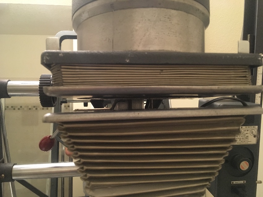

I came today to post this exact question! I just got myself a Beseler 45M and I was wondering what I should do. My two options are getting the 6x6in ilford set and just resting it on top of the negative carrier since the head doesn't seem to have a slot for filters.
OR there's a filter drawer that's right behind the lens but it takes 2 2/3" filters. So option two is getting the 3.5" ilford filters and cutting them down.
So to the brain trust: which is better?

I think the filter drawer above the negative is where you put them. I ordered the 6x6 ilford set recently but there seem to be other brands recently. If it is a 45m the 6x6 is the right size, I think 3.5" is for the 23c. Can anyone correct me if this is wrong?

My issue being that my head doesn't seem to have a filter drawer above the negative slot. Not like one I've used on other enlargers. Heres a picture for reference, sorry If I'm missing something silly!

The condenser head that came with my 45MX doesn't have a filter drawer either but does have an under lens, swing away filter holder. I've never used the condenser head other than to power it up and see it light up and so far have been just using the old dichro head that also came with it.

The traditional wisdom is that acetate filters go between the source and the negative, while gelatin filters go in the optical path (the negative between the filter and the source)
because the gelatin filters do not degrade the projected image as the acetate filters do.
Kodak Color Compensating (gelatin) filters go 'below the lens', while Kodak Color Printing (acetate) filters go between the source and the negative (in a filter drawer of the condensor head).
