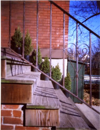

FP-100C for pinhole use
If you've got the setup for Polaroid-type pack film pinhole photography, Fuji's reasonably priced FP-100C (3-1/4 x 4-1/4, 10 exposures to the pack) is worth a try. I've found the colors to be very nice, with no reciprocity problems in daylight shooting. (Haven't tried it indoors.)
