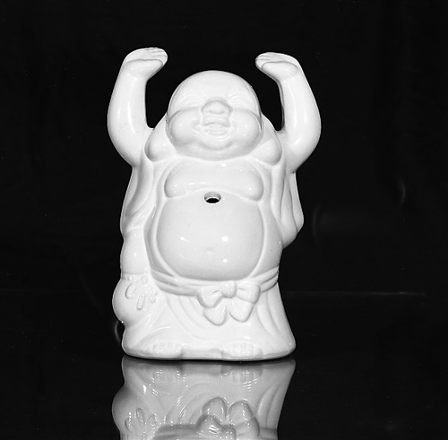

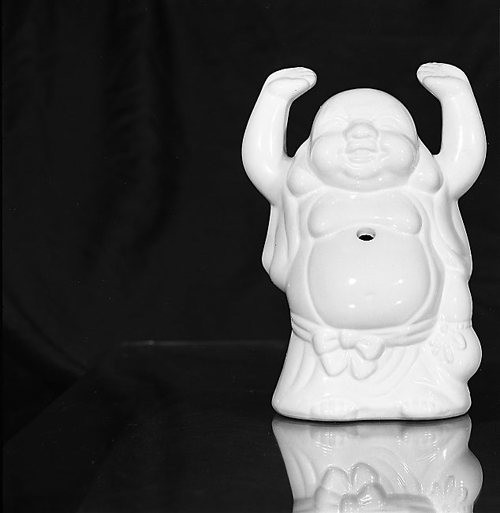

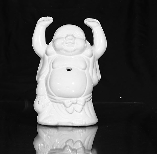

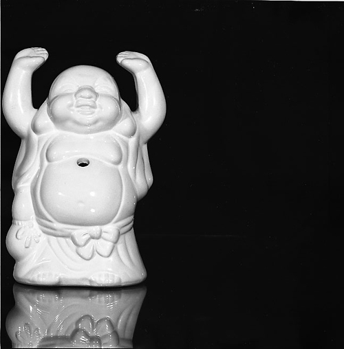

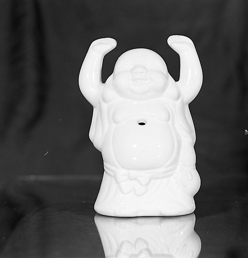

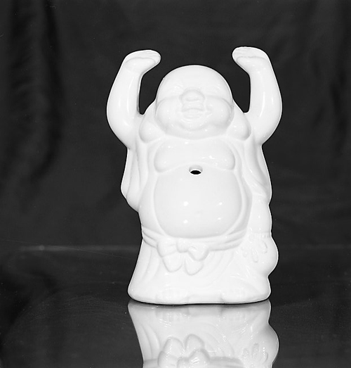

This is the second roll of film I have developed and I was using it to check my Sekonic L508 Light Meter.
Lighting 2 Strobes no diffusing material 1:1 lighting ratio
Film Ilford Pan F Plus rated at 50
Shutter Speed 250 for all shots
My meter gave me a reading of f16.5 @250
Frame
5 - apature 32
6 - Apature 22
7 - Apature 16.5
8 - Apature 16
9 - Apature 11
10 - Apature 8
These are scans of the negative and only had unsharp mask and resized. no other corrections were made except by the scanning software.
the rest of the roll was a little blank a gremlin left the slide in.
On another note I used 400ml of solutions this time and as you can see had no band of discolouration. I got a little better at loading the film on the reel all though there was one part that collapsed on one below it and it did not develop that section. Its a good thing it happened on the bad frames.
Please let me know which you think is the correct exposure. I think it is either frame 8 or frame 9 is near the correct exposure. I was focusing close so I was suppose to add a stop for bellows extension.
Thank you
- Dan

panastasia
Jun 8, 2007
624
Dedham, Ma,
Med. Format Pan
I vote for #8 as correct, but #7 looks the best on my CRT (more detail).
JBrunner
Dec 14, 2005
7,429
PNdub
First of all, we would have to assume that the scans represent the characteristics of the negative, and not that you would print them that way, so my comments are largely subjective, and based on the appearance of the scan as a positive representation of the negative, and I am judging which neg I would choose to print, based on what I see as a negative, not that I would print it to look like the scan.
That being the case, I would choose to print neg #5, as it hold the most highlight detail, and as the background needs be dark, it offers the most control in the printing process. It would be easier to print the thinner #5 neg to put the figurine where you want it, and still hold the background down to featureless black, as I would choose to have that value, or as near to it as I could get. That is opposite of what I would usually choose in practice, and my choice reflects the values present in this particular composition.
For a different subject, I might choose a completely different exposure for the same light. There is no generic "correct" exposure in practice, unless you have a generic "correct" subject. (Like a grey card) One needs to consider the subject and intended print to arrive at the "correct-for-your-print" exposure. In the end, you are exposing for the print, not the negative.
FWIW your meter appears to be working fine, and your process is giving you good latitude, and you could probably pull a passable print from any one of these with more or less work, depending on which you chose to print.
I'm looking forward to seeing more of your work.
YMMV. :smile:
