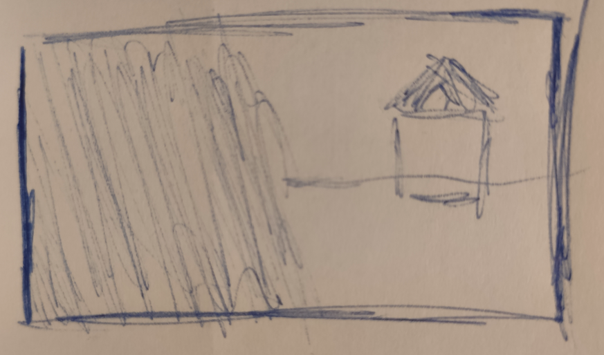

So, I know there are manuals that just by the "draw" of what can you perceive with the back open, you know which courtain is too slow, but I can not find that information for this model. Here there is a drawing of while holding the camera from behind, without lens and with the back open, I can see firing at 1/1000. Sometimes I see the full frame, so works fine, but if I repeat it soon or later I see at 1/1000 that they dont sincronize properly.
I hope you understood my explanation, ahahah.
Sometimes I can only see around 20% of the right side. Anyway the inclination of the perceived blurry shutter is alwas the same.
Also, when I cock the shutter, the last half of the moment has a strong squeak sound. Any idea which part of the mechanism should I regrease? or should I just open it and find it by observing?
Thank you in advance.

The first curtain travel time should be 14.0-15.5 msec, then adjust the second curtain to the same transit time. Then you may need to adjust the eccentric at the back of the camera (figure 3 in the manual) to achieve 1/1000. It is also possible to adjust the rotational position of the second curtain release cam to alter the slit width.

Shutter speed is the combination of the travel time of the slit across the focal plane, and the width of the curtain slit. Lots of things can be wrong, including excessive friction in the travel of a curtain.

The camera needs service. Twiddling with the curtains tension settings will make it worse.
Increasing first curtain tension will make the right hand portion of your drawing even more overexposed and cause the escapement for the lower speeds to run too fast.
