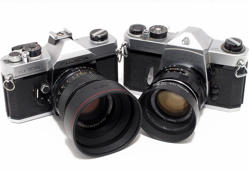

Hi,
I've collected a bunch of M42 lenses which I use more or less regularly on that type of camera I'm seemingly not allowed to talk about here :smile:angel:smile: and I really want to try out analog now. Problem is, the two cameras I tried were failures so far. First try was a Fujica ST 801 which I bought some time ago with a Fujinon lens I wanted and which was put on a shelf since then. The camera has a problem with the shutter curtain so half of the frame isn't exposed correctly. I only put through one roll and don't remember it exactly, but judging by the pictures I think it only affects the 1/60 shutter speed. But I'm not sure. It seems to be a common problem with this cameras.
Next try was a Fujica ST 705 which I got extremly cheap. The case was "well worn" or more precisely almost disintegrating. The light meter isn't working, I guess something is broken. Didn't test it any further.
So now I'm wondering which camera I should try next. I tried Fuji again because I have two Fujinons and thought about using the open aperture metering. But it's not necessary. My lenses are only the standard stuff like Helios 44M, Pentacon and Porst-labeled Cosina stuff. No Takumars or the like with proprietary mechanisms exept the Fujinons of course.
  • I want a camera with a working and trustful light meter, as I'm not an expert in guessing the exposure and don't want to use an external light meter or my smartphone either.
  • The camera should work without mercury batteries.
  • The camera should work with my Fujinon lenses without me having to cut off the aperture lid.
  • It shouldn't be on the pricey side. I don't know if analog is at all something for me, I just want to try out.
Looking at local offers (to avoid something like the ST 705) I found a Chinon Memotron CE-2 and a Yashica TL Electro X. The Chinon's case doesn't seem to be in very good condition but it would come with a bunch of accessory and was in use in the last time according to the seller. The Yashica looks very nice but was lying around for years (as was my ST 801) and I don't think it's the best prerequisite. What do you think? Or should I watch out for a Pentax Spotmatic? Or something else? Or should I screw the early 70's stuff completely and look for, I don't know, a PK or Minolta mount camera an adapt my M42s? Would this work at all regarding the light metering?
