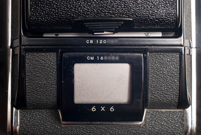

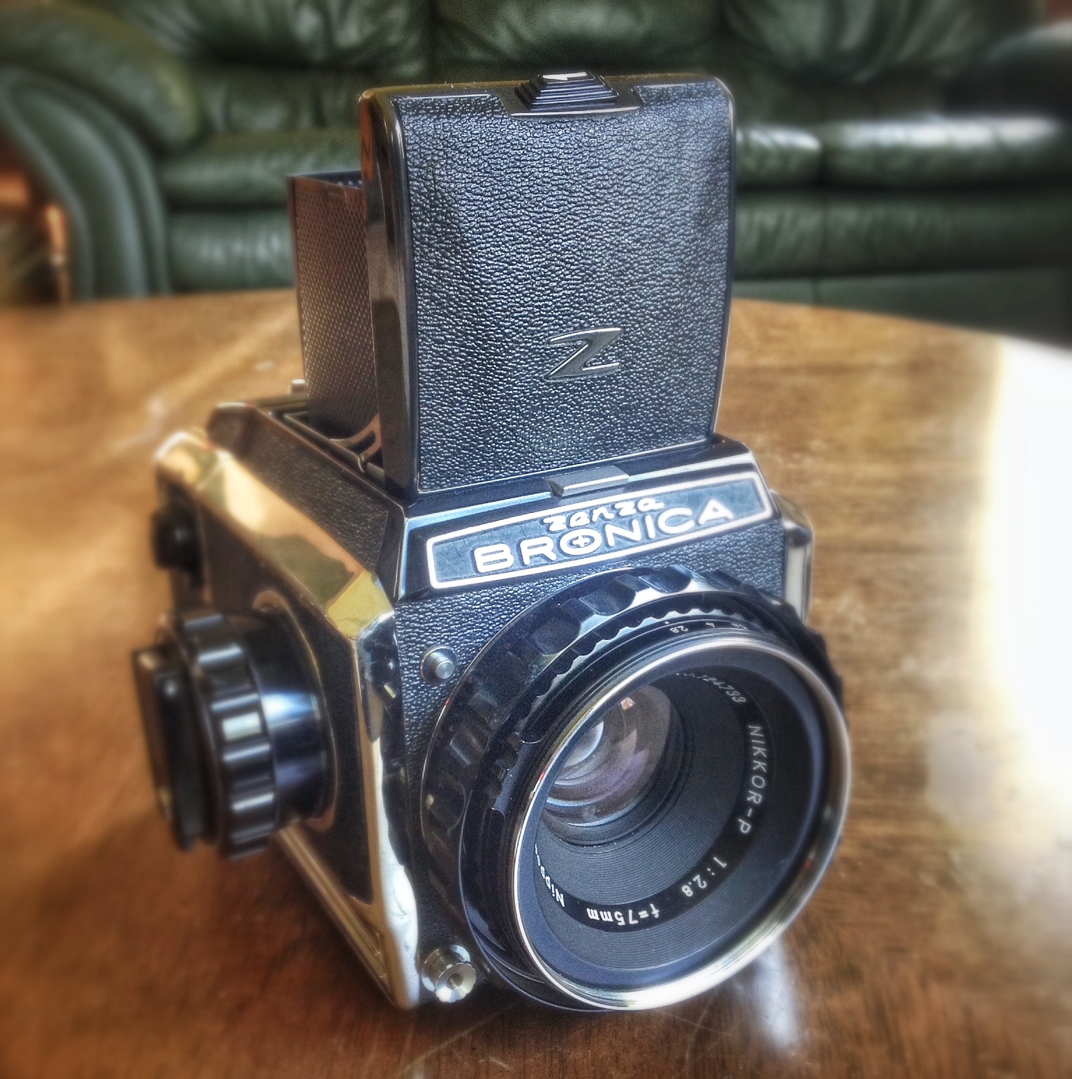

I just received a classic Bronica today picked up from a certain online auction site, but my research so far is giving my contrary indications about whether I have an S2 or an S2a. It was advertised as an S2 and I bought it on that understanding though I'd be a little happier if it turned out to be an S2a. The serial number is in the 120000's and lacks the S2a extension which indicates this should be an S2.
But the winding knob which I understand is the only visible distinguishing feature between the two versions appears to be the S2a style.
Any theories about the contradictory identifiers or have I just misunderstood something?
Also, as was noted in the description, the back won't come off. Pressing in on the dark slide seems to cause something to begin releasing but only barely. I understand there are two styles of dark slide for these cameras. The one I have has a curved leading edge. I was wondering if it was possible the problem is that I have the wrong style and if so is there any way to tell? Alternatively is there any other common cause for this issue. I can get by without removing the back for now but eventually I hope to get a second back so I can switch film as the situation dictates.
Later S2A's dropped the suffix from the serial numbers. Looking at my collectors guide, the S2A wind on knob is more conical than the S2. You're appears to me to be a S2.
S2A Type 1 S/n Range: 100,000 S2A to unknown. Can't really tell from the pictures.
According to this and your serial # it looks like you have an S2 (scroll down to S2a). http://www.craigcamera.com/trivbronica.htm
The S2 has brass winding gears which were replaced with steel in the S2a. It is recommended by some to advance the film by turning the knob instead of folding out the handle and winding it so you use less torque and save the brass gears from stripping.
This is the main source of confusion as the serial number information all points to this being an S2, but the information I've been able to scrounge says the opposite of what you got from the collectors guide - that it's the S2 knob that is more conical and also that the S2 wind lever is bare aluminium rather than black like I have. For example there's a few examples with photos at www.dirapon.be/bronica.htm, about 4/5th of the way down the page. The same information can be gleaned from Camera-wiki. Either way though I think it's probably true that this is an S2.
Would it be easier to change the serial number or the winding knob?
You could have a transitional model, but that would be more likely if the serial number was at the end of the S2 range.
Maybe the only way to know for certain is to open it up and look at the material of the winding gears. You may be lucky if this S2 had stripped brass winding gears that were replaced with the tougher steel gears, and an S2a winding knob was added to signify the change.

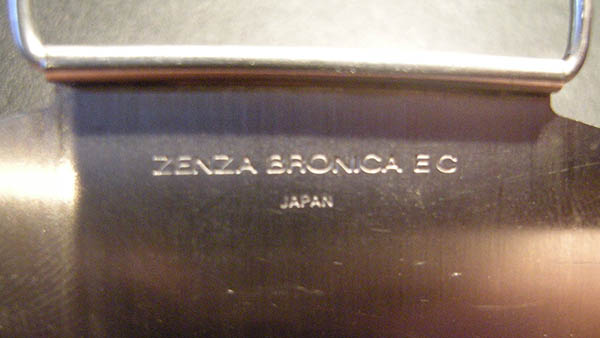

As for the issue with the back not coming off, I may have the mystery solved. It turns out the dark slide it came with is for the EC models and these are a little shorter.
Hopefully getting my hands on the correct S2 dark slide will solve the problem.

Judging by the winding knob, you do have an S2A. I have four S2As and they all have a winding knob similar to the one on yours. I found photos of the S2 knob in the very helpful book "Bronica. The early history and definitive collector's guide" by Tony Hilton, and it's shape is much more conical, in addition to other details that differs.

Well, this is the thing - the knob says S2a, the serial number says S2. The sources I found say that there's a particular serial number somewhere in the 150000's after which S2a's didn't carry the designation in the serial number but as mine is in the 120000's this implies it's an S2. That's according to the online sources I found anyway, but if you heard something different that could be interesting if you remember the source. Assuming what I found is correct then what Frank said earlier makes the most sense, it's much more plausible to think that someone replaced the knob with one from a different model (this was done with the darkslide after all) than that someone altered the serial number.

In my case I did manage to come up with a workable, if somewhat inelegant solution. By unwrapping the sheet metal that held the wire handle and flattening it out I got that little bit extra length I needed and the back comes off just fine.
I still think you have a S2A. According to Tony Hiltons book S2A serial numbers go from CB 100 000 to unknown. The book also has an image of a S2A body with serial number CB 118178 without the S2A suffix, just like your camera.
