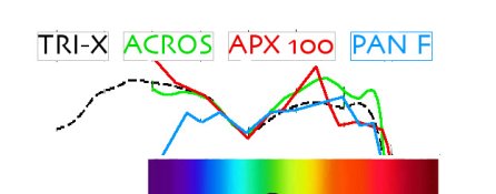

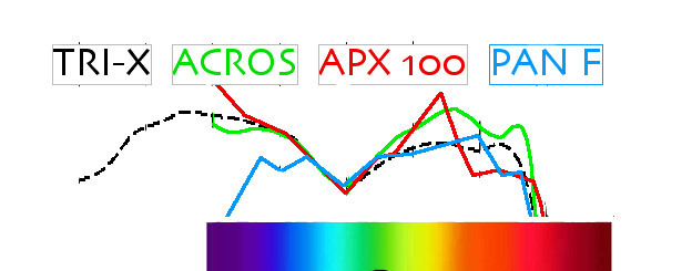

df cardwell
Jul 16, 2005
3,357
Dearborn,Mic
The magic spectrogram
Depending on the film, no filter will show them relatively neutral.
Yep. Films all see color differently. By this, I mean that if we idealize some 'perfect neutral film', all the rest have some sort of built in filter. Not flaws, it's how they were designed.
TriX passes for neutral. Some are more sensitive to red, some less. Our choices today are paltry compared to the '50s, but we can make the most of our choices if we take a look at the spectrogram most film makers publish on their poop sheet. We don't need to do a critical analysis of the chart, just get a hint at what the film might do, then go give a test drive.
A few rolls of TriX and a color chart are all you need to begin. See how the colors are different in daylight and under tungsten lights, with their built in orange filter. Contact print them.
Then check Pan F, or Acros. And if you have a Wayback Machine, some APX 100. Get to know the spectro shape that you like, and screen films that look promising.
Warning: Kodak, Ilford, and Fuji use different proportions for their charts - reshape them before you starting drawing curves. (Not that I've ever made THAT mistake before !)
Below, see 3 films overlaid on a TriX color graph.
For a Portraitist, APX 100 will darken red, AND lighten blue (Relative to TriX). Pan F lightens red and darkens blue. Kinda handy outdoors, eh ?
