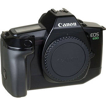

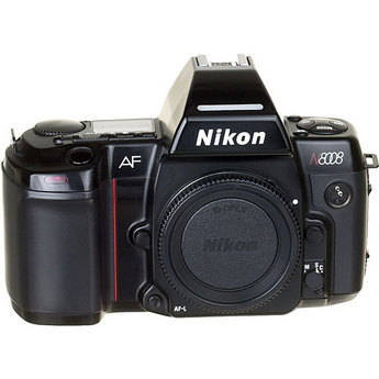

I am working my up from Digital point and shoots (Sony)--->DSLRs(Sigma)--->Mu4/3(Fuji XE-1)---->rangefinders (love me some Voightlander)---and now to SLRs (OM2 sp, Minolta SR7) I now want an Autofocus body. Why? Because can't tell the difference when I use the DOF preview
Don't want Minolta because i read that their hot shoe mounts are proprietary.
So any of tips as far as ease of use and ergonomics trump being able to use manually.
Canon EOS?
Nikon N?
Body OIS?
Lens OIS?
Thanks,
Lyn

Nikon system is great because you can use all the older AI/AIS lenses, as well as any pre-AI lenses back to 1959 (if they've been modified).
Something like the N80 is a good place to start - lightweight and inexpensive with a lot of good features. N90 is also a very good camera. F100, F4, F5 are all pro-level cameras and can be found for great prices too.
I have an F100 and F4, and the VF and metering displays are outstanding. For a fairly lightweight, do-everything body, it's hard to beat the F100.

It depends on the class of camera. While most of the older/cheaper EOS cameras had a pretty basic AF (only 1-5 AF points), the EOS 3 was highly sophisticated. EOS 30/33 were somewhere in between. Either if you chose Nikon or Canon, considering how cheap these cameras are today I would go for one of the later advanced amateur/semi-pro models (EOS 33/30 or EOS 3, Nikon F100) if you budget does allow for it.

Don't have experience with Canons, but have been very happy with Nikons for 40 years. My first autofocus was an 8008s which is very nice, but the F100 adds matrix metering and the F6 is leaps beyond this. Can't speak highly enough about the matrix metering on the newer bodies.

I don't think you can go wrong with either Nikon or Canon. They both have very comprehensive and competent systems. Both use in-lens image stabilization, which has the benefit for cameras that use an optical viewfinder that the viewfinder image is also stabilized. In any case I suspect in-body stabilization would be problematic for film cameras as you would have to move the film around....
Nikon has the benefit that you can use the older manual focus lenses on an AF body (but of course then you don't get AF). Canon introduced the new EF mount for their AF bodies, which was not compatible with the older manual focus FD mount. But by doing so they gave themselves a clean slate to work from, and arguably came up with a better AF system, using in-lens motors for focus, than the original Nikon approach using a motor in the body driving the lens. I think this is borne out by the fact that Nikon later adopted the same approach with their AF-S lenses.
If you do go with Nikon, it would be worth getting one of the later bodies, that have support for AF-S lenses and VR (image stabilization). Some of the earlier bodies, such as the N6006 and N8008, don't support these features. The F100 that has been mentioned by several others would be an excellent choice. With Canon, AFAIK, all their AF bodies will work with all the EF lenses (except the EF-S lenses for crop sensor DSLRs), although of course later bodies will typically have more sophisticated AF and metering systems

N90s - super cheap, very capable, usually can be found with the extended grip. Many backs have the rubberized coating fail into a sticky mess, which can be scrubbed off with alcohol and profanity.
8008/8008s - built in multiple exposure, which I used a lot pre-photoshop. No grip was made by Nikon for this model. (N90s needs a special back if you need that).
Those are the best of the super-cheap bodies I would guess... many later film bodies are excellent, the plasticy ones above can be found ridiculously cheap. I have an N90s, an 8008 and an 8008s, bought them new and used the hell out of them professionally - they're still going strong.
