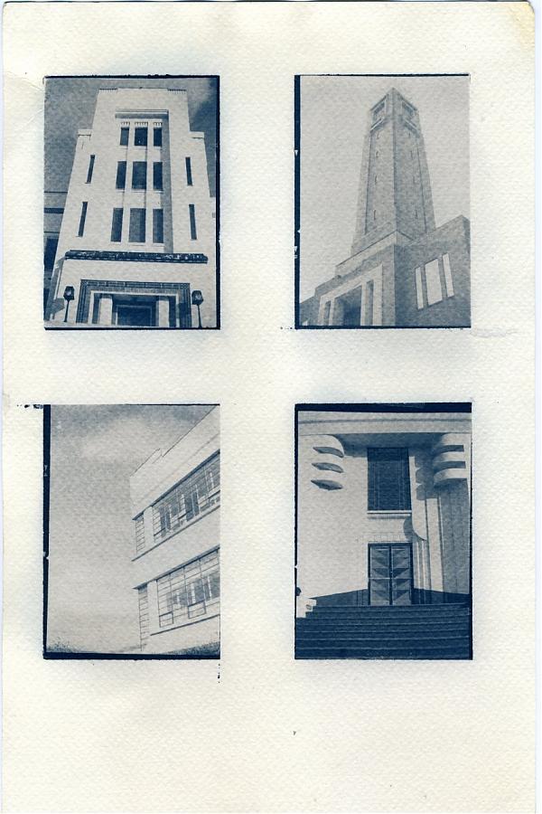

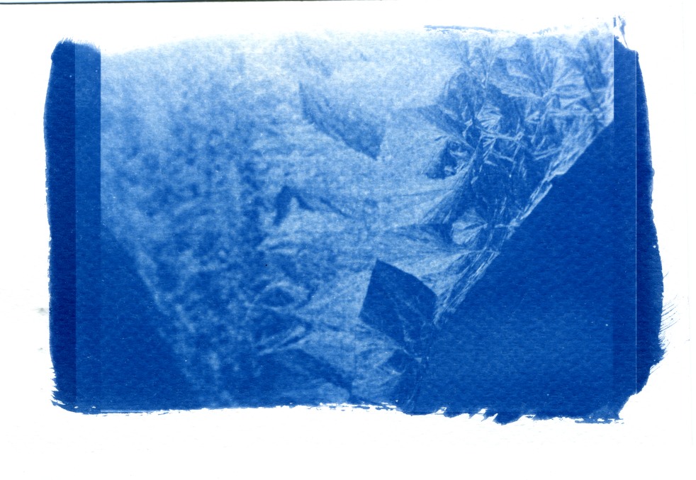

(example of medium format grouping of cyanotype toned in coffee and an example of enlarged negative cyanotype attached)
