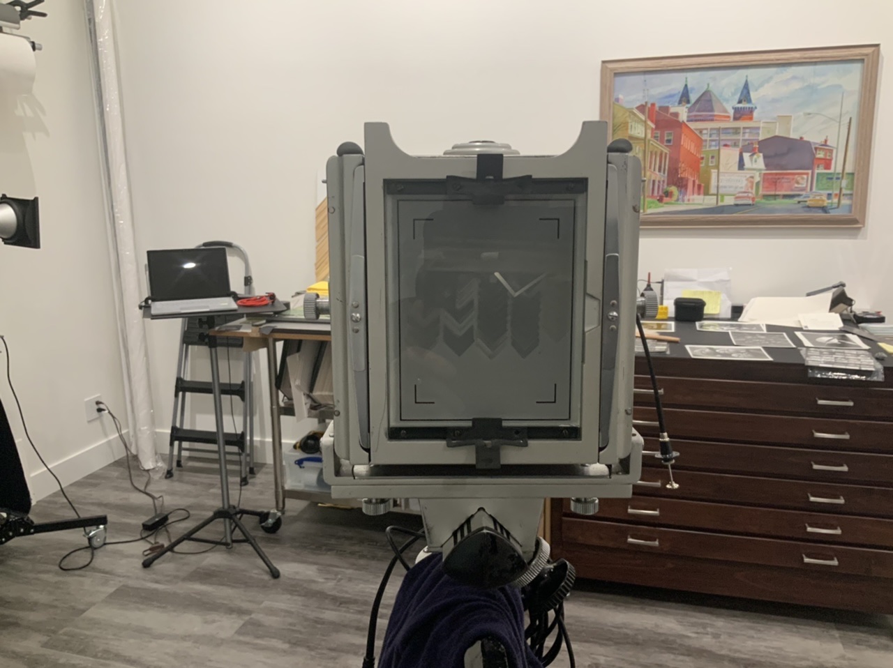

I’m going to start using my Graphic View camera, starting in the studio, then possibly outside close by. Too heavy to carry around to far! Seems like there should be a brighter and better screen, so I would like to get some opinions before I order one.
Thanks

I have a Graphic View II (it was my first LF camera, and I still like and use it, but not in the field anymore). I really like the Fresnel viewing screen that came with the camera. It's hard to tell from the photo if you have a Fresnel screen or not. If not, regular ground glass is dimmer. Many prefer regular ground glass because the illumination is more even. In any case, make sure your lens is set at its widest aperture for viewing and use a good dark cloth.
If the ground glass is dirty, a gentle wash in mild detergent will often do the trick. However, if you have grid lines on your ground glass, be sure to test them for solubility before washing. I've washed the lines right off of one ground glass :cry:

Thanks for the tips. Mine has very very fine fresnel lines. I found a Fresnel on eBay for cheap, but it has no grid or frame lines, which I prefer. Grid would be best.

Well, the stock Graphic View Fresnel viewing screen is among the best I've seen. I'd clean it up and see if that helps (be very careful with the plastic Fresnel portion of the screen, it is quite fragile and prone to scratching). If you need grid lines, make yourself a transparent overlay with the marks you need on it. You can print one fairly easily.

Does mine look stock to you?

The best I've seen is what I'm using currently. Arca Swiss designs their rear standard so that the Fresnel screen can be used between the ground glass and the lens. That provides a really excellent viewing experience.

So I’m assuming it will only work on a Arca Swiss standard?

I have fresnel lenses on all my view cameras. I think they all would be difficult to use without. Also, faster lenses help this issue. For example, in 4x5 I'd call F11 slow, F8 average and F5.6 fast and f4 or wider, super-fast.

Yes, The Arca-Swiss fresnel/GG setup really only works with an Arca-Swiss camera. The issue is that with our design the focus is set in a certain plane that matches the film holder.
To put an Arca-Swiss Fresnel/GG setup in place some material will need to milled to adjust focus on your back. So not reversible.

That's correct; Arca Swiss has designed their tolerances to compensate for the effect that their Fresnel lens will have on the plane of focus. (Sorry for the late response; just saw your query.)
