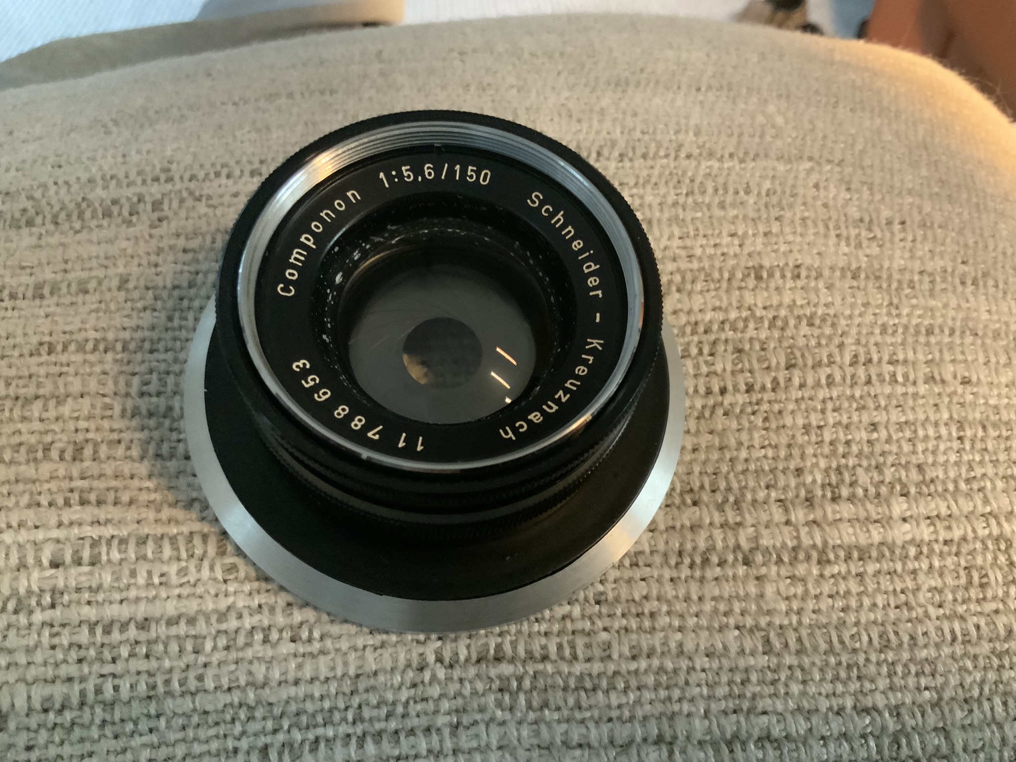

I need another lens for enlarging 4x5. I currently have a Componon f5.6/150mm but I need a bit wider lens so I don't have to drop my table when doing 20” prints. I’m thinking I may need a 135mm. My Durst enlarger has a 4x5 mixing box. The Pictograph manual lists Rodagon 5.6/135 and Componon-S 5.6/135. This lens will be used for 8x10 - 16x20 and the existing 150 Componon for up to 40”. While looking for the suggested lenses I have discovered what seems like many versions of them. Which version should I be seeking and are these lenses optimal for the amount of enlargment I will be using them for or should I be looking for something else.

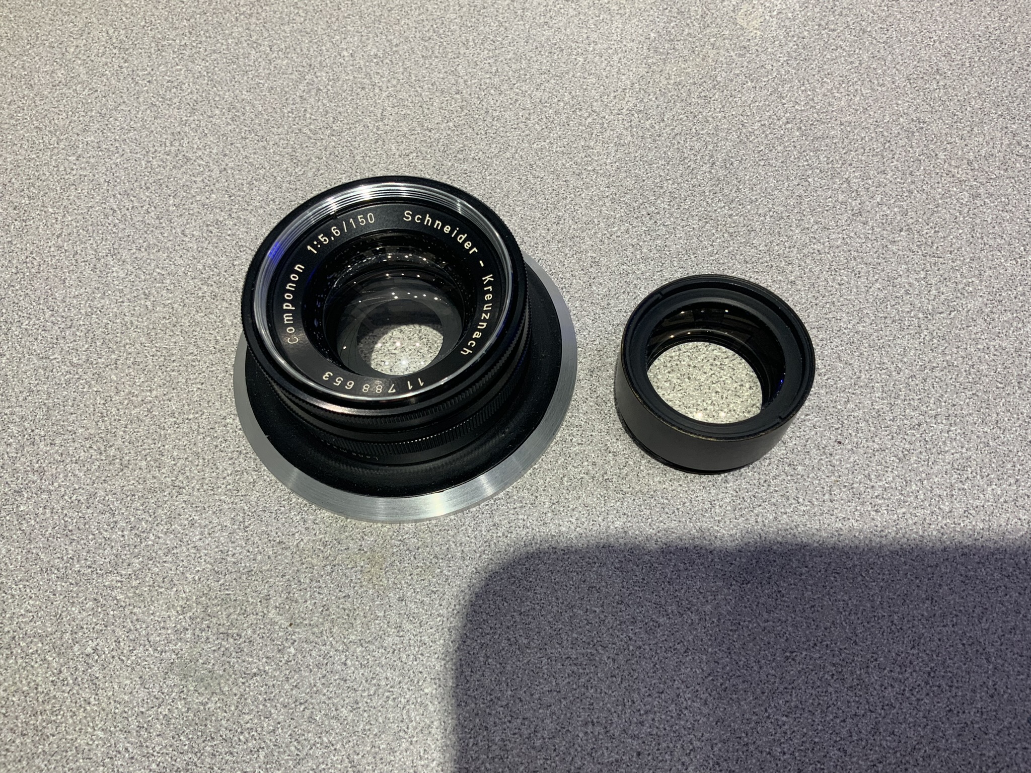

Darn, I already purchased a Schneider-Kreuznach Componon-S 5.6/135mm. Turns out I didn't have the rear element of the Componon 150/5.6 installed. I got a bunch of lenses given to me, and had no idea what that piece was for because they weren't on lens boards. I'm hoping this lens will perform well for prints 16x20 and smaller. I'll purchase another 150 for larger prints.
