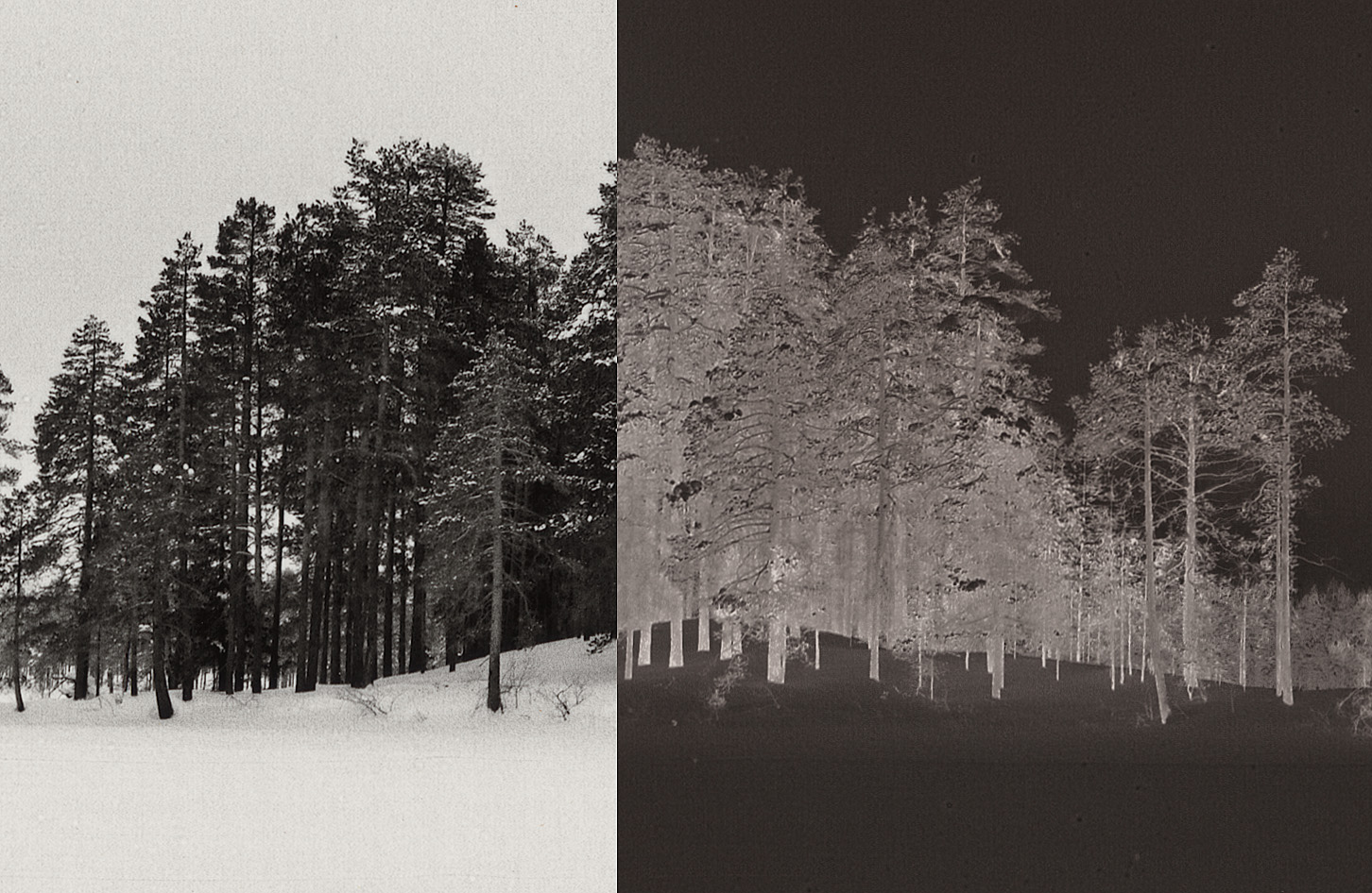

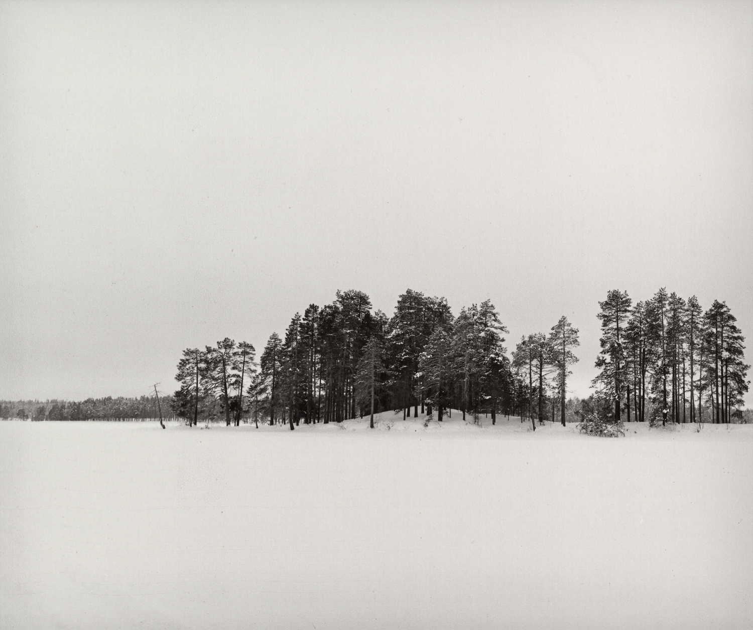

Here are two images from an 8x10 print and negative made for Lodima Fine Art Grade 2. The original capture was made with a D800e and converted and edited in photoshop. The very smooth areas of sky and snow and the dark sharp areas in the trunks made this a torture test kind of negative for glossy gelatin-silver chloride contact printing. It will never be as smooth or as sharp and a camera negative, but it is pretty darn good considering the limitations.
