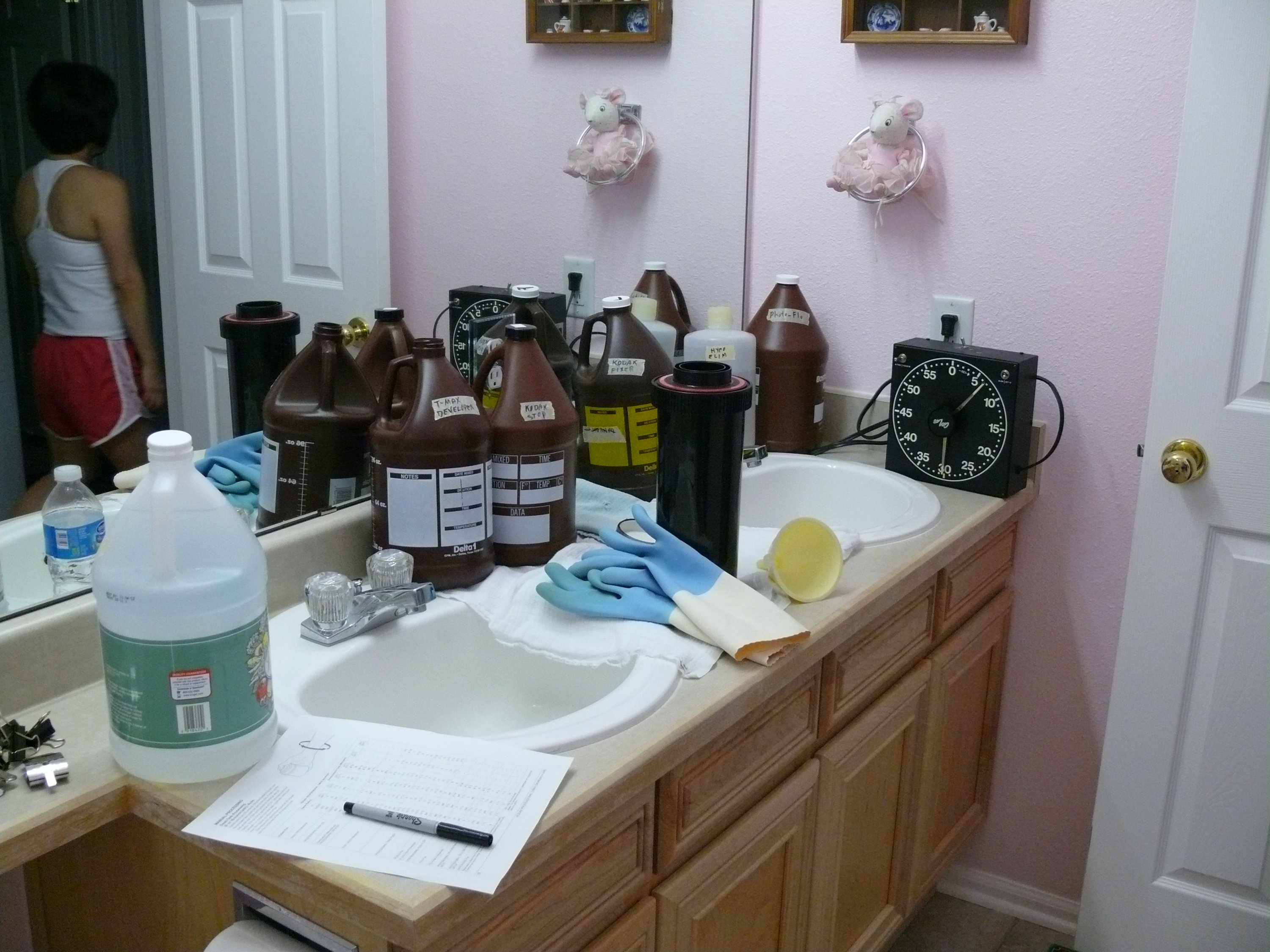

Load the reels inside a dark bag and here's all the space you need. Not having a darkroom yet, I go hybrid for printing. But that subject is out of bounds for apug.

:tongue: Personally I'd want more shelf space. But a double sink is nice.
So where you keep your spent fixer bucket?
pbromaghin
Sep 30, 2010
3,861
Castle Rock, CO
Oh, I only need one of them every few months.
