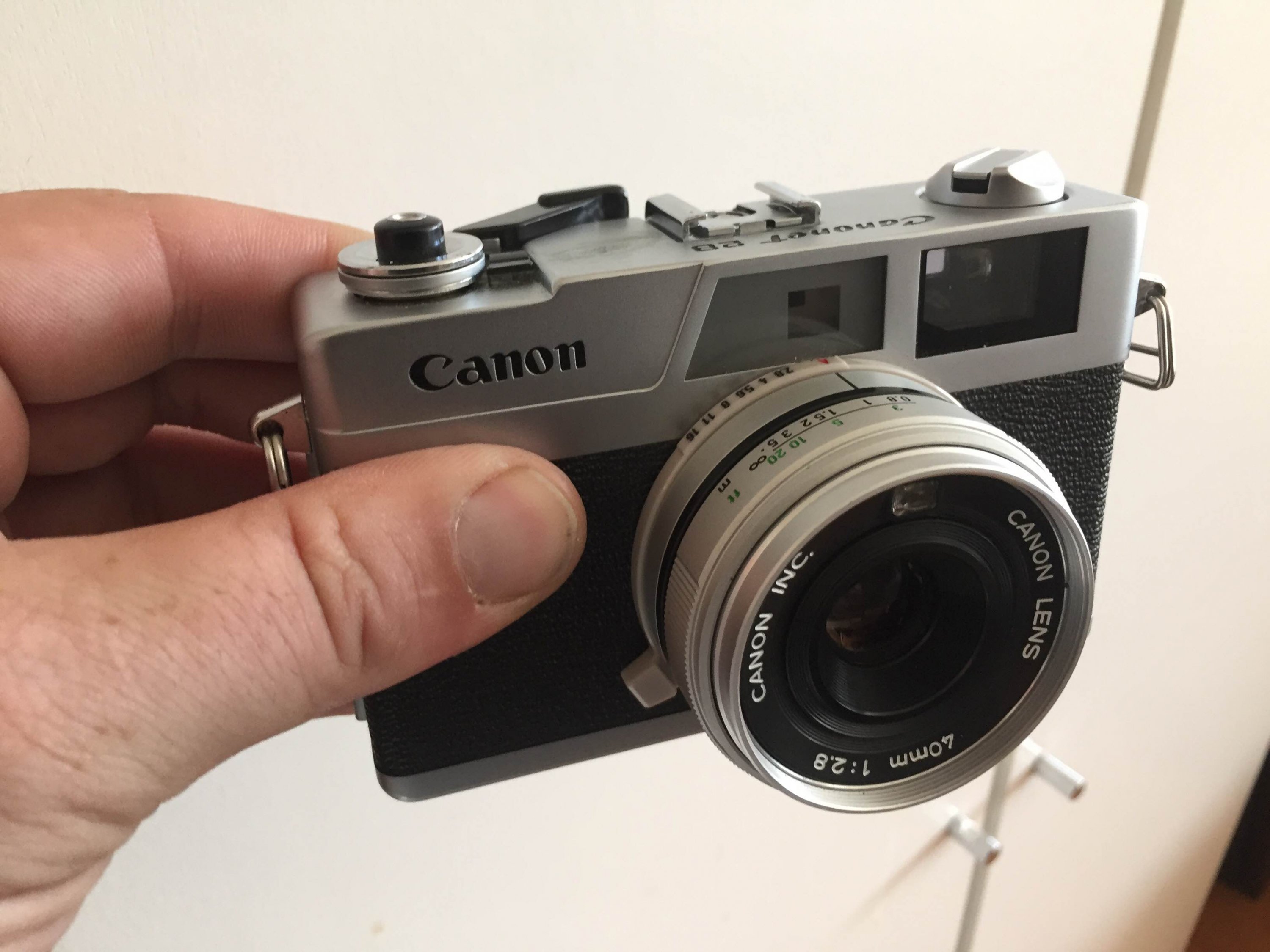

Hi all, I found this camera at a thrift shop for next to nothing and would like to replace the light seals as an educational project for myself and my daughter, who will receive the camera afterwards. I realize a new version of this camera can be had for pennies on eBay, but that's not the point, it's about the project and time spent together.
So can someone recommend where I could purchase the "foam" material to fix the light leaks and any adhesive needed?
Thanks! :smile:
Attached are pics of the camera:
