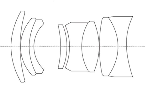

Yep, flea market will be, I will buy couple of old zoom and close ups, disassemble it, then I will see what I have that looks like this:
joking, joking of course :smile:.

That lens might be a life long project. But I did pull a single meniscus lens out of an old 75-230mm zoom lens that covered a 4x5 negative with ease. The problem was, it had a 14" focal length, and my Speed Graphic (my only LF with a focal plane shutter) wouldn't extend that long. Luckily it did have another achromatic doublet inside with about a 50mm focal length that worked pretty well as a macro lens on a 135 with bellows, though it did need a Waterhouse stop to make it useful.
