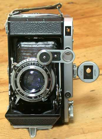

Here is a picture of the camera with the accessory finder attached. Improves use about 100%.
Now I have to find a reason to use this 50 year old folder when I have modern Fuji 6X9 and a Mamiay 711 system!! But there is nostalgia in the act.
Sandy King
