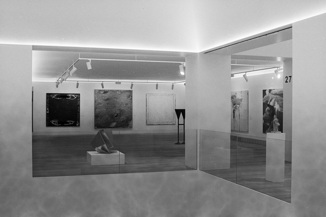

Hi,
I'd appreciate your help/opinion. Noobie question: what went wrong here?
attachment.php
Let me explain.
I went to a trip and shot six 135-rolls, different types. In two of them, I have got results like the one shown above. Not all negatives within the same bad roll show that "patterning" but mostly do. I cant understand what I am doing wrong...
The photo above is from an Ilford PAN 400, shot at 400. I developed this roll in a tank together with a second roll of PAN 400@400. All negatives from the second roll were just very-fine - therefore, I thought, perhaps I make no mistake developing these films. Note that both rolls are almost new, far from being expired. I stored them in a fridge, and took them out only for the trip. So, to say, identical conditions for both films, still... one is good and the other one is just bad.
I have used D-76 1+1 for 13 mins at 20C. Then, Uncle Mort's stopper. Then, A-300 fixer (5 mins). Washing, etc.
The problem is not in the scanning. I can see the problem clearly with my eyes already in the negatives.
Any suggestion?
Much appreciated.
I would suggest the top roll in the tank has slipped up the center column into the froth on top of the developer for part of the development time.
Be sure to give tank a good solid rap on workbench after agitation to make sure reels have slipped to bottom.
Its also possible you have too little developer in tank but I would have thought that would give a much more marked line through negative.
Given the strange lines in the darker parts of the picture, I would say that Rob is right - I think the light lines in the print (dark lines on the negative) are where developer was running down the film while the reel was above the liquid.

Thanks everyone. I found the reason thanks to your comments.
At first I tought... nope cant be... the rolls are well secured inside the tank... and certainly I am very careful using the proper amount of liquids. But...
Last week, in one of those cheap Chinese shops, I found nice flasks w/ measuring scale, meant for cooking. They were just perfect for me, for replacing my old ones. And very cheap too. Bought a set of 3. Well... I have just found out that the scale of those flasks is ca. 10-20% off!!!! That is I was using a significantly lower amount of developer (fixer, stopper, etc), indeed.
D'oh.
