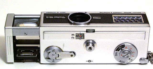

Here's the film plane indicator on a little Rollei 16S:
Some cameras have this. Some don't.
