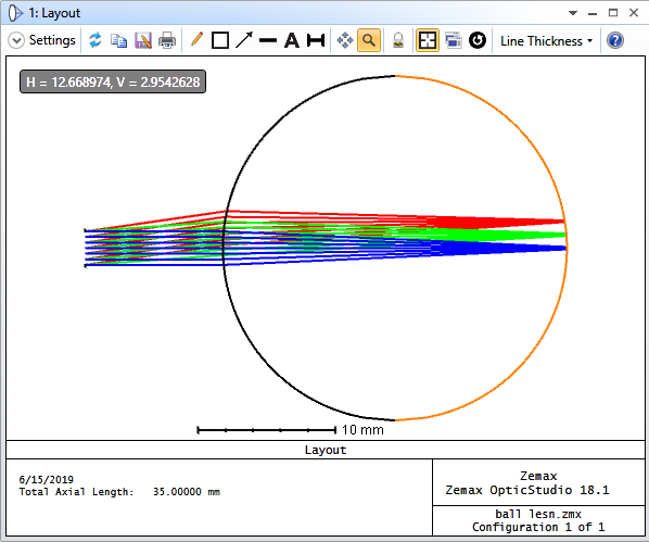

Edmund optic 45-539 is probably your best bet, with a 4mm or 2mm image circle. This is the optical layout of that lens. Your eye is to the left. The colored lines are tracing the rays through the system to that 4mm (as modeled) diameter image circle

Note that you could encase all of the lens in epoxy except for the actual parts of the surface that the light rays pass through. So you could have a square ... thing ... with a bump for the front optical surface that you are looking through.
The simulated image of a 4mm tall picture on the back of the lens. This is what you would see looking through it.
If you want smaller, here's the simulated image of a 2mm tall picture on the back of the lens. This is what you would see looking through that.

The diameter of the ball lens that I show above is 1” diameter. The proportions are accurate so you can measure off that screenshot (just like old school off a map). It’s showing a 4mm tall image. If you want a smaller lens then scale down the image height as well.
Buy one and start tinkering. I could write 1000 words and you’d still know less than if you held one in your hand.
