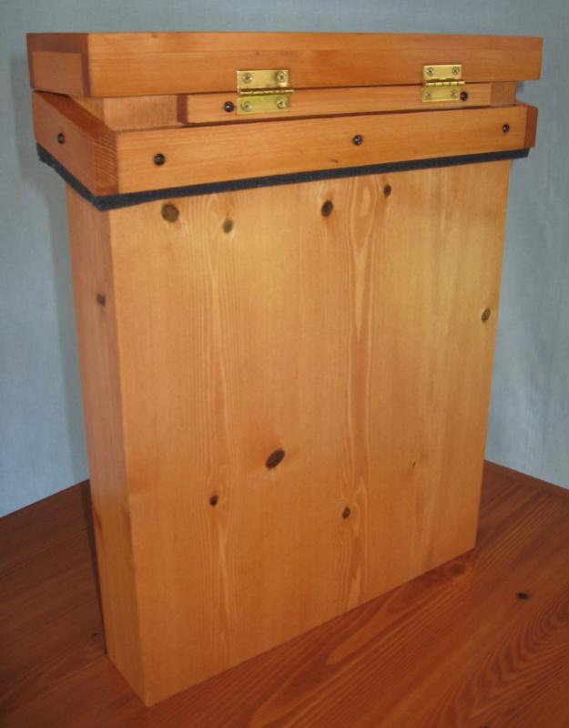

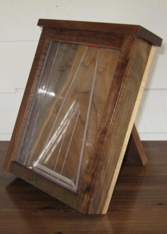

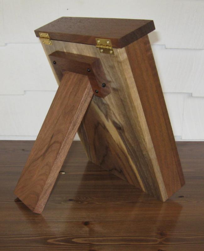

Got some prices from Steve if anyone else is interested:
Steve said:
6. PLATE RACK - This rack is built with a V groove and will hold twelve plates. It is available in walnut, cherry or oak. * $40.00
  • * For a rack to hold plates larger than 11 x 14 add 50%.
  • * For each additional groove, (6 maximum) add $4.00.
7. SILVER BOX WITH LID – Standard box is available in pine or poplar. For walnut, cherry, or oak add 20%.
  • *$60.00 Up to whole plate *Add $25.00 for stand if needed*
  • *$90.00 Up to 11 x 14 *Add $25.00 for stand if needed*
8. FIXER BOX NO. 1 - This fixer box is used inside the dark box. It comes with a lid to keep down the fumes. Standard box is available in pine or poplar. For walnut, cherry, or oak add 20%.
  • * $60.00 Up to whole plate
  • * $90.00 Up to 11 x 14
9. FIXER BOX NO. 2 - This fixer box is used outside the dark box. It comes with a hinged lid to keep debris from entering the fixer solution. It also comes with an attached fold in stand. Fixing outside the dark box gives you more room inside the dark box. Standard box is available in pine or poplar. For walnut, cherry, or oak add 20%.
  • * $85.00 Up to whole plate
  • * $110.00 Up to 11 x 14
10. PLEXI BOX - I use ¼” plexiglass. Includes dipper. Plexi box is to be used with item numbers 7, 8 and 9.
  • * $35.00 Up to whole plate
  • * $50.00 Up to 8 X 10
  • * $55.00.00 Up to 11 x 14
11. HELPER TRAY - I use ¼” plexiglass.
  • * $30.00.00 Up to whole plate
  • * $40.00.00 Up to 11 x 14
All looks very well built
Regards, Art.
