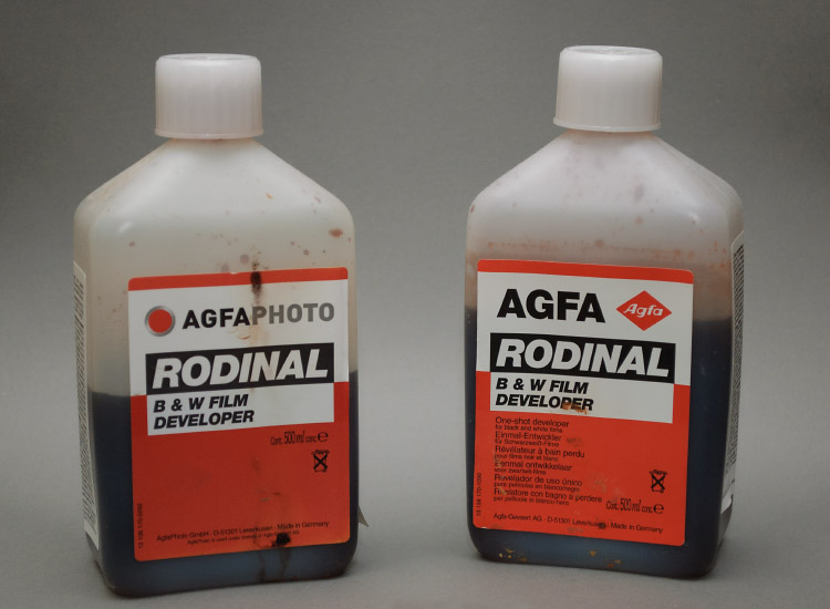

I have two partially used bottle of Rodinal. One is perhaps bought 5-6 years ago, the another one.. I can't remember.
I just run a test batch with a Rodinal mixed from the older bottle (in the attachment, the left bottle). The results were really uneven. Actually I haven't never seen so bad results before. My luck that I used Rodinal for sheet film developing test, not for a real photograph.
As I have always read that rodinal lasts for decades, even century I wonder that how and when will rodinal actually go bad?
When rodinal is badly expired/exhausted, does it give uneven results or only thinner negatives?
The reason for uneven development ist not old developer, but too less agitation. Weak developer leads to weak density in the highlights.

You didn't develop in a aluminium bbq tray did you? was it face up? face down for the sheet? Initial agitation?
I developed face up. Plastic trays.
Four kind of methods: Slosher tray (just testing the idea), Paterson Orbital agitated like slosher, tray and one sheet, agitation by lifting corners and jobo drum.
As I got much better results with D76 (same agitation, same trays, ..) so I suspected Rodinal.
But I have to do some tests to ensure that it is really rodinal that plays some role in very uneven development. It could be also film + developer combination that just don't work well.
Did another test, now with D-76 and Rodinal using again Efke 25 sheet film.
Now I took Rodinal from the another bottle (the right one bottle on the attachment picture of the first message).
Really even result! Perhaps best I have ever got from Efke 25 and Efke 50!
The D-76 and Rodinal 1+50 gave similar results so fault was not caused by the film or my tank.
So I guess that the another bottle of Rodinal is somehow gone bad. Ofcourse another test would make this assumption clear.

The showed bottles: Agfa (before 2004) and Agfa Photo 2004-2006. Silar plastic bottles, almost no diffusion like glas.
