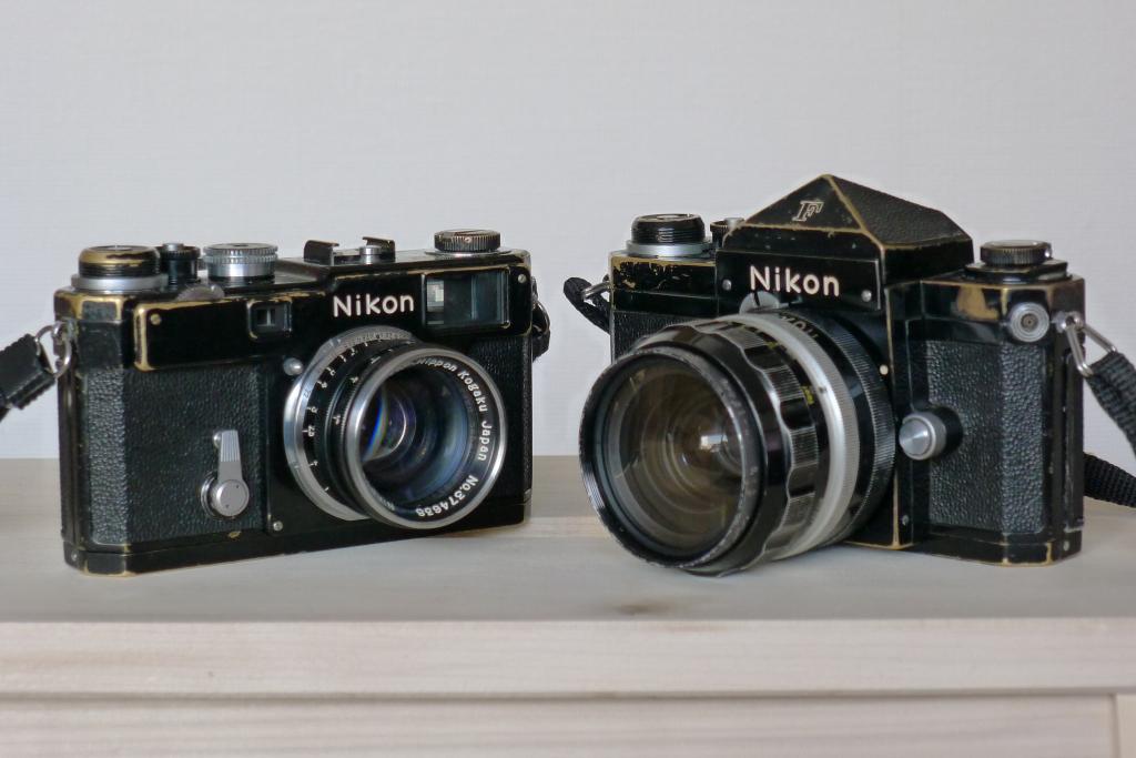

You know, it's funny because a camera was announced this week that has a brass top plate specifically to develop brassing! This is very much a feature of this camera.
I remember in the late 1960s when there was a recession in the aerospace industry in Southern California and camera stores were loaded with rangefinder Leicas the laid-off engineers sold off. They were always in perfect conditiion. Certain types of folks who do not use cameras for everyday down-and-dirty work carry around splendid looking expensive cameras and a lot (not all) in-the-trenches professional photogs look down their nose a little bit at something too gorgeous. I have an old beat up Nikon F that I used to photograph the Beatles, a Muhammed Ali title fight and Elvis. I treasure every scuff and dent.

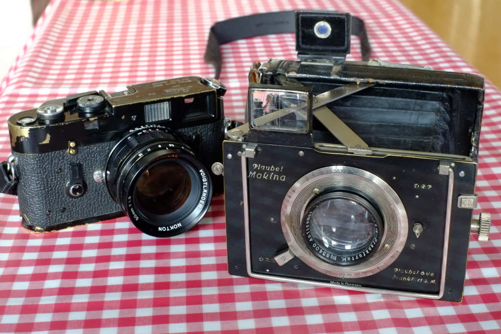

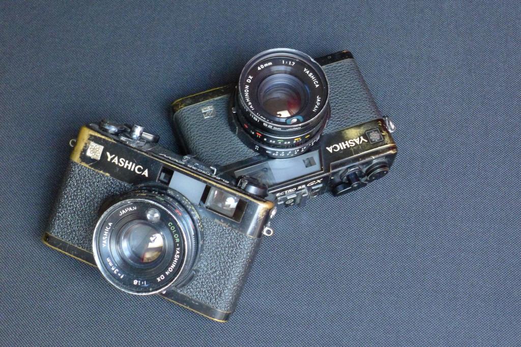

Camera Patina..
My Rollei 3.5F has patina. True.. cosmedically it's not perfect, but once I get back Fleenor it will operate to near perfection. I think Patina on cameras look pretty cool.

I like brassy cameras,

If only my Contax RTS had more brassing. Fortunately, there are a couple of dents on the prism. :tongue:
Leave it alone. Let it age gracefully.
I agree. I hate scratches on my cameras, particularly if it's through my carelessness, but normal brassing on the edges is no prob. I have a set of binoculars used in WW2 by a now-deceased relative, which carry all the marks of action, and could no doubt tell a lot of exciting tales!
