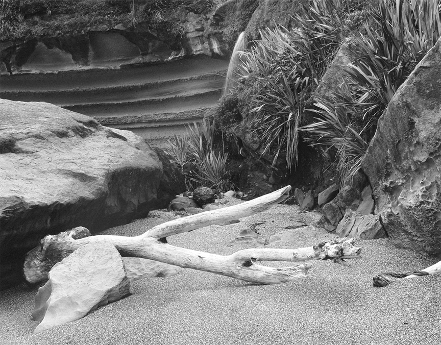

When I was silver printing from 4x5 negatives, image size of about 15x19, TMax100 was pretty sweet to me.
