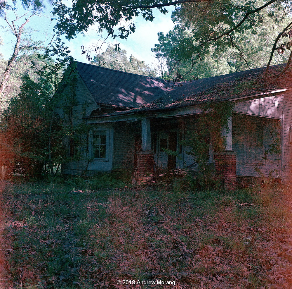

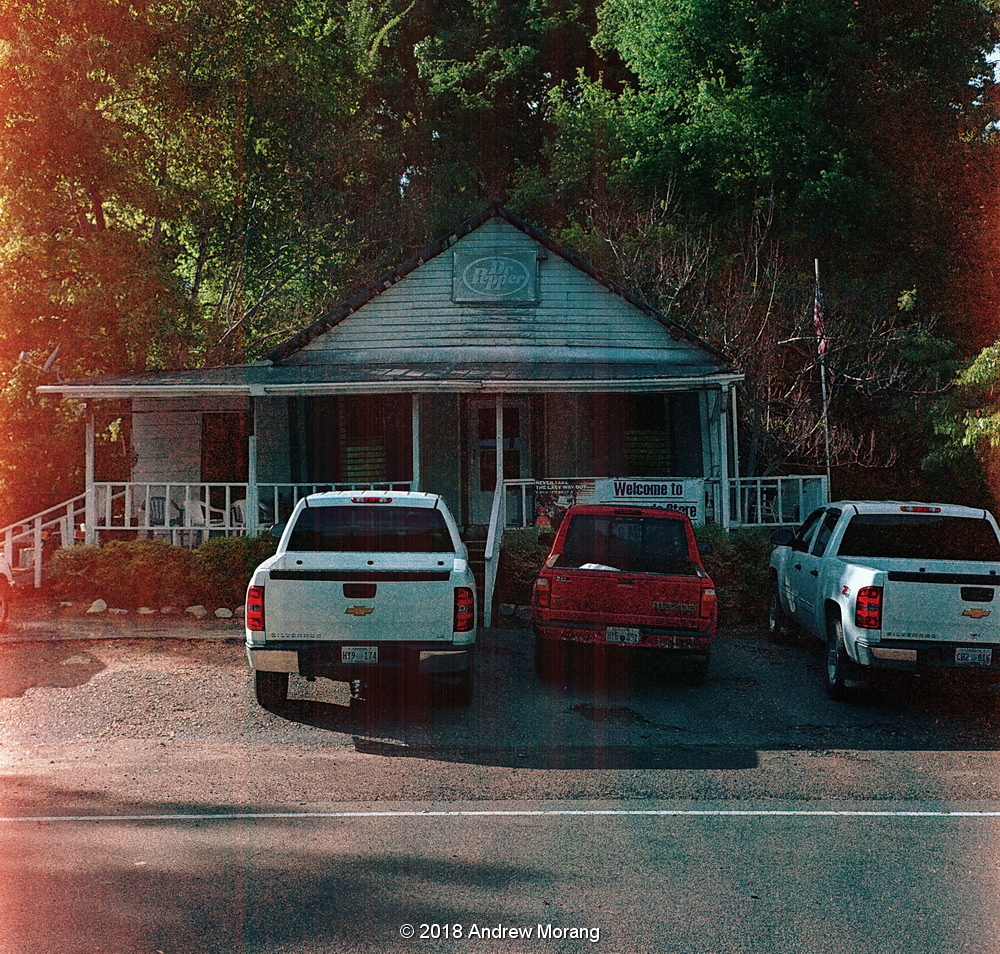

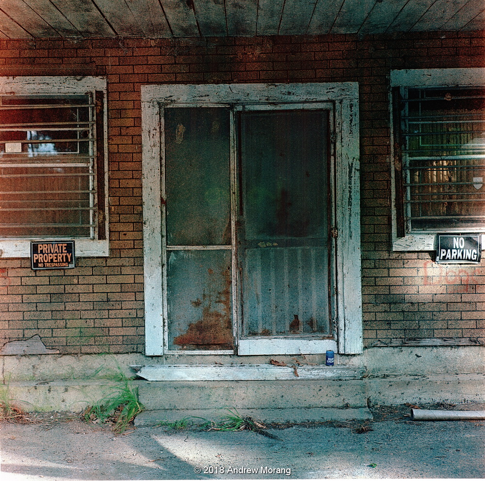

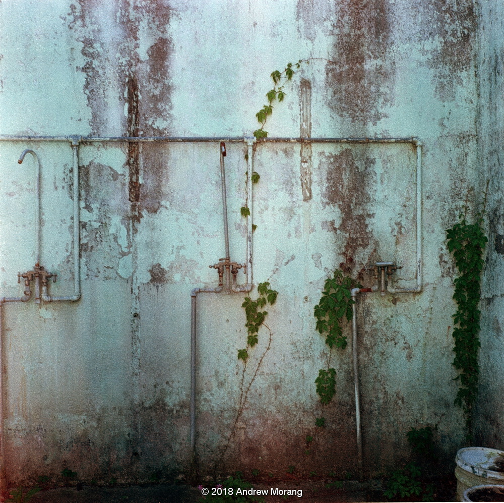

Hi Folks, I finally used the last of my stock of long-frozen Kodak Ektar 25 color negative film. It was quirky and a bit hard to use, but had a unique color palette. As a test, I bought two rolls from a seller who honestly said he did not know the storage conditions. Many of these expired films come from estate sales, where a buyer opens an old camera bag and finds film. This time the film was clearly ruined. Of a roll of 12 exposures from my Rolleiflex, most were grossly underexposed, and I could only extract 5 frames. I used an exposure index (EI) of 12, but possibly if I tried EI 4 or 6, I might have saved a couple more frames. Here are a few samples, and I rather like the funky colors and streaks. All are from central Mississippi, exposed with a Rolleiflex 3.5E with 75mm Xenotar lens.

Interesting results. Indeed, as you say, "unique". Interesting color palette. Still very sharp.

One more example from the long-expired Ektar 25 film, an abandoned house off Old Port Gibson Road, Reganton, Mississippi (about 20 miles SE of Vicksburg).

The very thing that made Ektar25 as sharp and fine grained, gave it the chance of having bad keeping. I think you have an example of this.
Great photos nonetheless.
