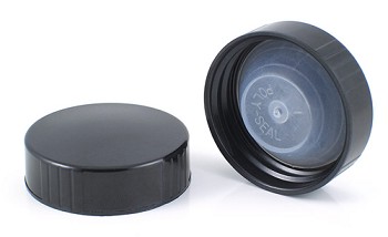

I kept a bottle of XTOL stock solution in a PET soda bottle with all the air squeezed out.
I found the bottle in a closet, it got misplaced during a move IT WAS 11 YEARS OLD. Looked like light beer. I used it on a test roll, it worked fine. I couldn't believe it. Glass bottles with a poly seal cone lid will keep solutions for years when stored at around 68°F.
RPC has got the results. I suspect splitting concentrates may not be the best way. Hermetically sealed glass bottles stored in a cool, dimly lit environment may be the best way.

This is a Poly Seal lid. Leak proof, air tight
