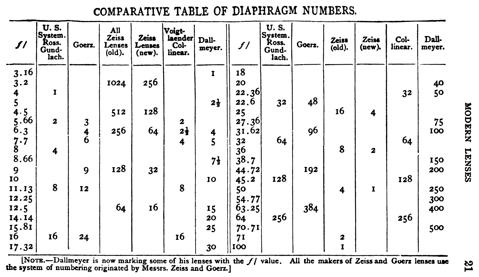

Indeed it is Dallmeyers own aperture numbering system which started by the number 1 and ended by the 500. The Dallmeyer system was based on exposure, proportional to square of the f-number.
The equivalent f/ numbers with respect to the Dallmeyer numerals on your wheel stop is as follows:
30 > f 17.32
40 > f 20
75 > f 27.36
150 > f 38.7
200 > f 44.72
..... derived from this table

Thank you Ron, I will put a piece of tape on the lens board with the scale!

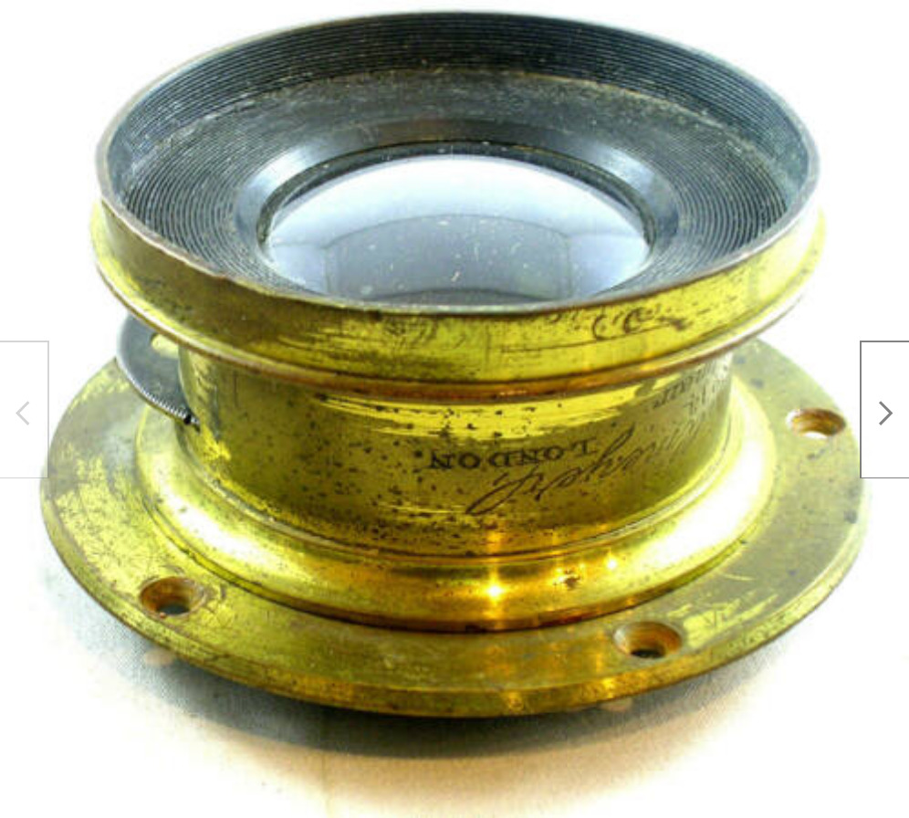

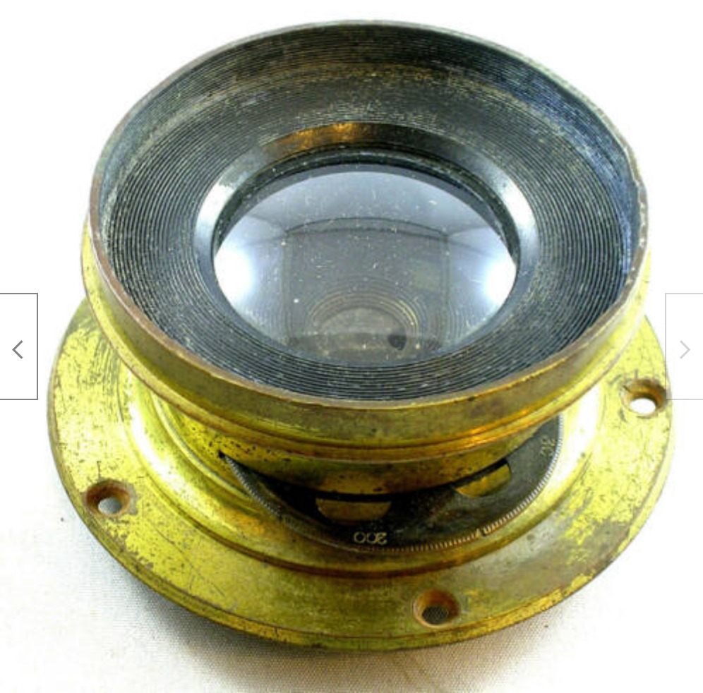

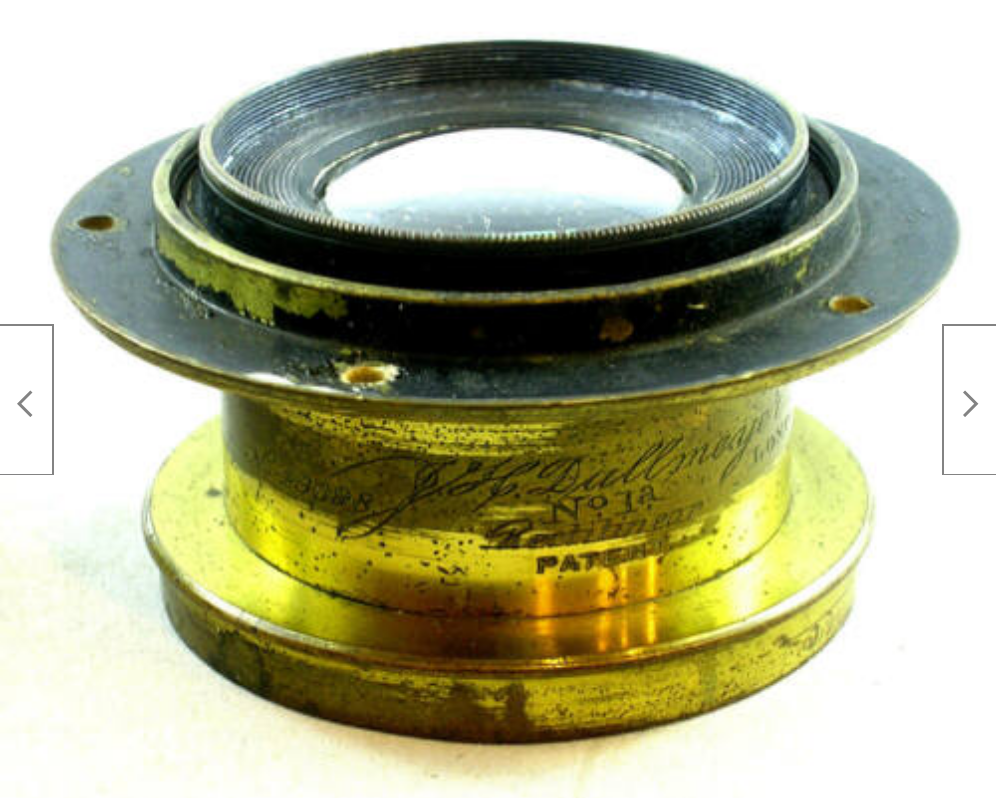

I believe you are correct it being a "wide angle rectilinear" . What do you think the focal length is mounted on my 4x5, approximately 127mm?
It has more resolution due to the lens formula/glass/smaller aperture?
Photos attached!

Thanks for showing the lens; have a comparable lens from Perken, Son & Rayment; indeed these are W.A.R. lenses. Don't know about the focal length. You can measure it by focussing the lens at infinite and measuring from the hart of the lens (about the same point where the diaphragm disc is situated) until the ground glass screen. My Perken, Son & Rayment is meant to be used for a half plate camera: 6,5x4,5 inch plates; no focal length is mentioned.
<edit> I just posted a picture of my vintage brass lenses; the Perken W.A.R. lens is on the far left, it has a max opening of f11:
https://www.flickr.com/photos/zorki_2007/50960743432/in/dateposted-public/
