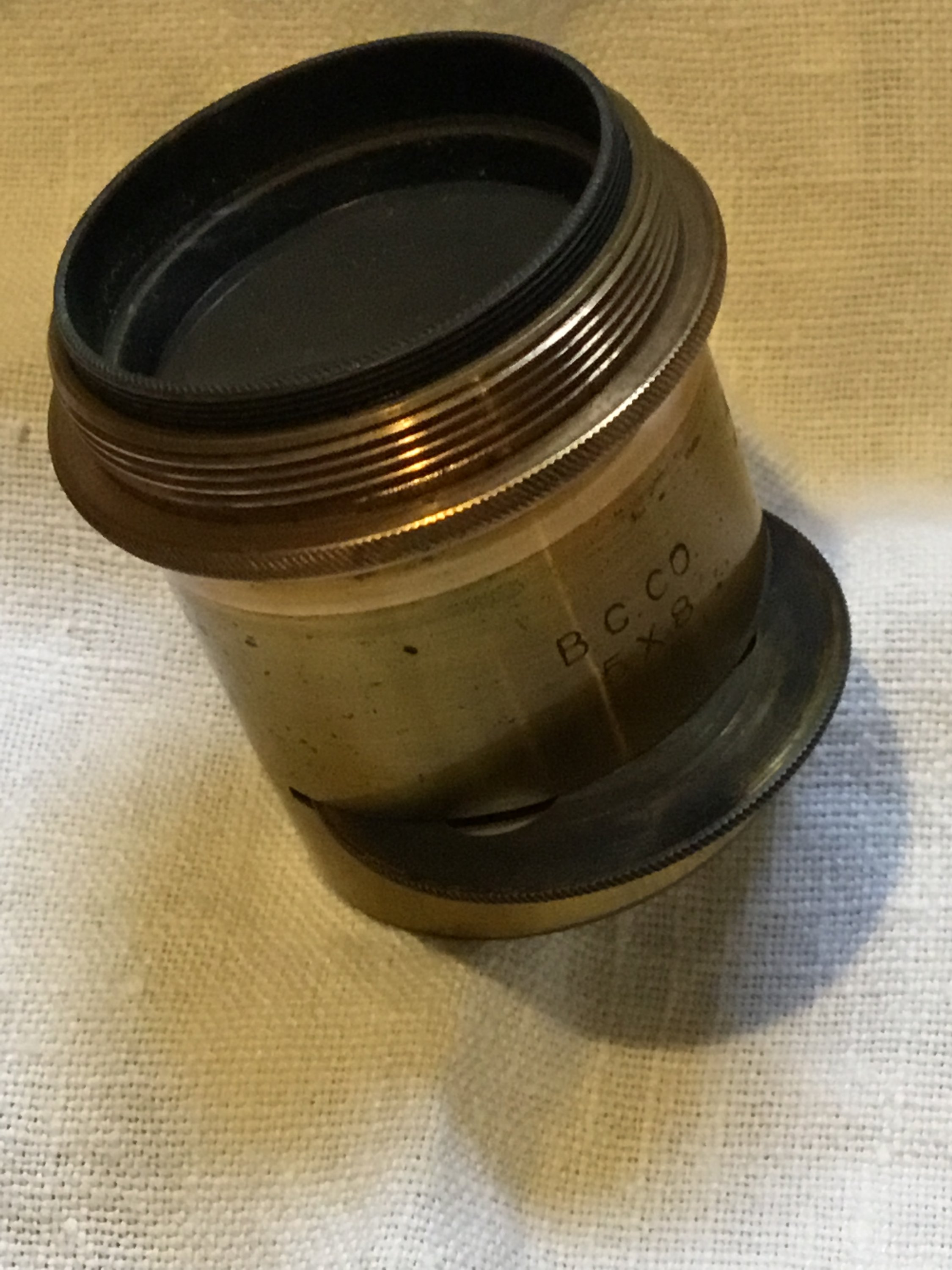

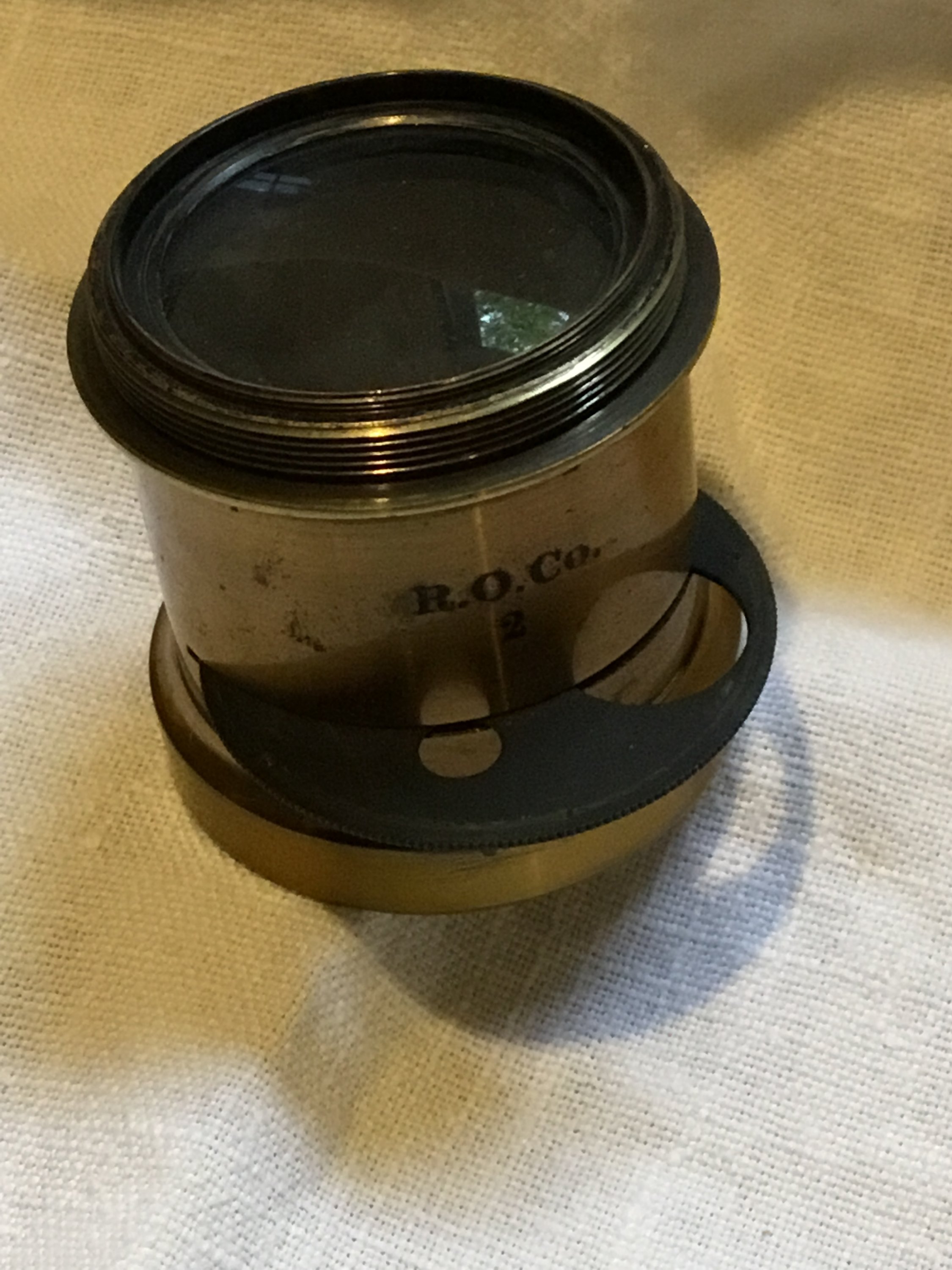

I have a R.O. Co #2 lens with a wheel diaphragm [4 stops] on a Marvel Camera, any literature or ideas on the f stops for this model lens? Also a B.C. Co. 5 x 8 [3 stops] on a ROC New Model View camera. Neither wheel has any markings.

Thanks for the link, no marking on either wheel unfortunately. I would have thought with the popularity of the ROC lenses someone has had to have already figured out the stops, and no info in the ROC sales catalog either.

So for future reference the Rochester Optical Co #2 lens [landscape] with rotating diaphragm has f stops of f16, f20, f26.6 & f40, this was based on a 10” focus [254 mm] from the original catalog literature.
The B.C. Co. 5 x 8 lens [same size as ROC #2] based on a 10” [254 mm] focus has f stops of f20, f26.6 & f40, based on my math, thanks for the help everyone.

I was wrong on the focal length, it is 11” not 10 making the ROC #2 f stops f18, f22, f30 & f44
The BC Co 5 x 8 lens also an 11” focal length has f stops of f22, f30 & f44
